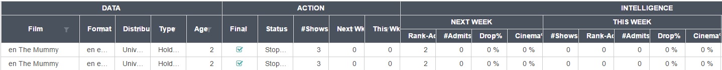

    Thank you for your guidance. I am still unable to figure out how to combine the multi-level header hierarchy (like here: http://wijmo.com/blog/creating-column-groups-in-flexgrid/ ) from your example. I have added an attachment with a picture of the desired outcome. The template that should allow me to put the drag & drop functionality must be defined on the ‘Film’ (first) column. If I create the HTML column with template and also include it in the columns list in the .ts file where I define the header hierarchy, it will double it.

    Thank you for your help. This seems to be the right way to do it. I still have a problem with creating a 3 layer header grouping, as in the image that I have attached. As you can see, the "INTELLIGENCE" section has two sub-sections ("NEXT WEEK" and "THIS WEEK") and each sub-section has it's own columns. Can you please provide an example of achieving such a hierarchy?

    Hi Cosmin,
    You can go for as many levels as you want. You just need to add rows in the columnHeaders. You need to get header value for each row as we did in the two-level hierarchy.
    You can also define column definition by yourself same as columns array if you know column information.
    For your reference, please see the attached sample that implements the same.
