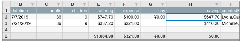

    There’s an issue I met about group aggregate with formula values. I did following to show a column footer to display total aggregates:
               // flex is an instance of wjcGridSheet.FlexSheet
                let row = new wjcGrid.GroupRow();
                flex.columnFooters.rows.push(row);
                flex.bottomLeftCells.setCellData(0, 0, '\u03A3');
    Then I set aggregate = 1 for all numeric columns. You would see that aggregate does not count values in formula. See the snapshots.
    Is there a way to implement this?

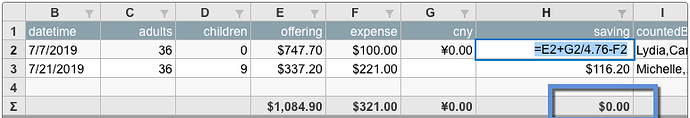

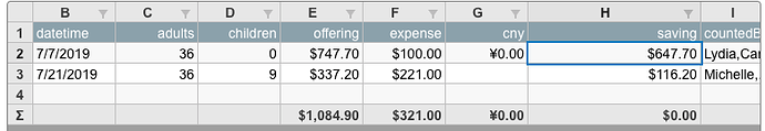

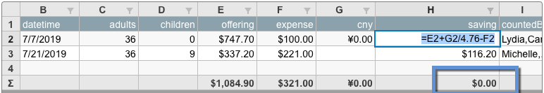

  • Posted 1 December 2019, 4:31 am EST - Updated 3 October 2022, 6:38 pm EST
    Sorry, another snapshot which shows values in formula is not counted:

    The aggregation in the formula column does not work properly because the aggregation is done using the actual data and not the data present in the FlexSheet. But in a column containing the formula, the actual data is string type and therefore, a summation cannot be performed on it. But, you can create your own method to aggregate the data and add it to the footer column. Please refer to the sample below:
    https://stackblitz.com/edit/angular-4vse8k
  • Posted 2 December 2019, 6:44 am EST
    Perfect! Thanks a lot for your help.
    Didn’t know FlexSheet.getCellValue(i, col.index, false) can be used to return evaluated value.
