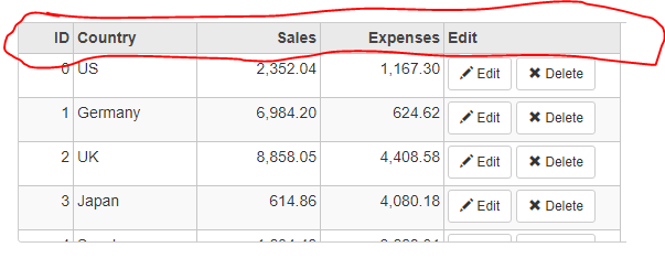

    Dear all,
    Anyone know how to custom column header name on FlexSheet ? I would like to custom the name instead of A,B,C,D.

    Hi Oskar,
    To achieve the desired behavior, you may need to override the updateCell method of CellFactory of FlexSheet. Please refer to the code snippet and the sample below:
    let oldCF = fheet.cellFactory.updateCell;
        fSheet.cellFactory.updateCell = function(panel, row, col, cell, rng, updateContent) {
          oldCF.call(this, panel, row, col, cell, rng, updateContent);
          if(panel == fSheet.columnHeaders) {
            let idx = cell.innerHTML.indexOf('<');
            let oldHTML = cell.innerHTML.substr(idx);
            cell.innerHTML = panel.columns[col].header + oldHTML;
    https://stackblitz.com/edit/angular-fpbkr6
