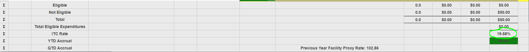

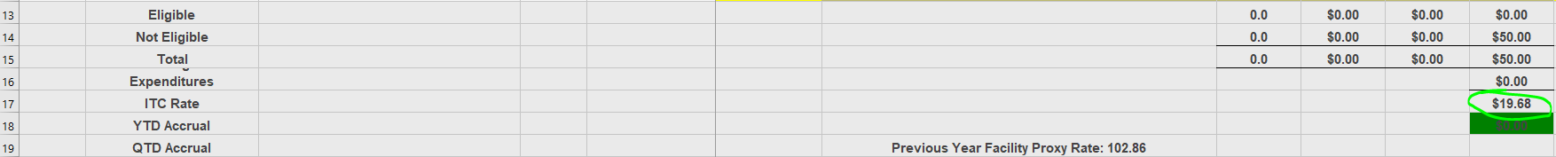

    I have a FlexSheet with custom footer calculations. I use itemFormatter to change a cell value to have a percent symbol instead of a dollar sign, since it falls under a monetary column. When I export though, the itemFormatter change reverts and the dollar sign reappears. Any way to fix this? See pictures below.

    To apply cell style while exporting the FlexSheet to Excel, you will need to first create an instance of Workbook class from the FlexSheet and then customize the cell. Please refer to the sample below:
    https://stackblitz.com/edit/react-1xyvtx
