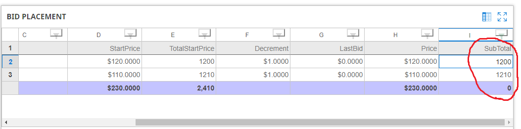

    I am facing trouble in adding group row in flexsheet footer. I had added below code in my solution which is working fine with number column but not with formula column
    var row = new wjcGrid.GroupRow();
    s.columnFooters.rows.push(row);
    s.bottomLeftCells.setCellData(0, 0, ‘\u03A3’);
    For formula column, it sets aggregation value as 0.

    The formula column is showing 0 because it is a string type column and the aggregate sum of string column will be 0. The formula inside the column gets evaluated and the result is shown on the column, but the actual data stored in that column is still a string.
    In order to show the subtotal of the formula column, you can use the evaluate method of Flexsheet control and set the result on the group row. Please refer to the sample below:
