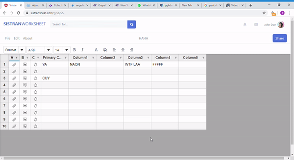

    I have an issue when I’m renewing FlexSheet data source from database periodically. Refer from this https://www.grapecity.com/forums/wijmo/flexsheet-row-header-visib#original-post when I’m renewing the data source it is always refresh and recreate the flexsheet. Could I only refresh the data without recreating the whole flexsheet ?

    The reason that the FlexSheet is flickering is that you have added formatting code in the sourceCollectionChanged event. Whenever the sourceCollection of the CollectionView changes, the formatting is applied again to the FlexSheet and that is why it is recreated.
    To avoid this, you may remove the formatting code from the sourceCollectionChanged event and add it to the initialized event of FlexSheet. Please refer to the sample below:
