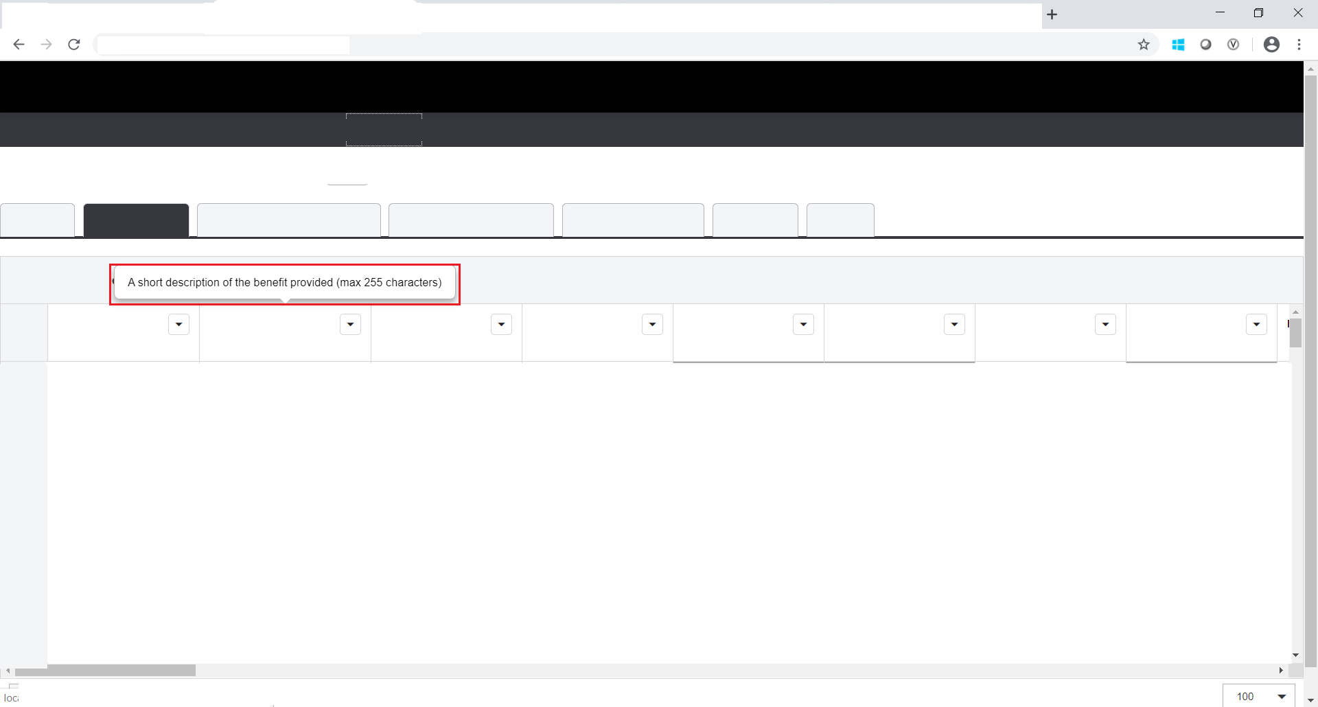

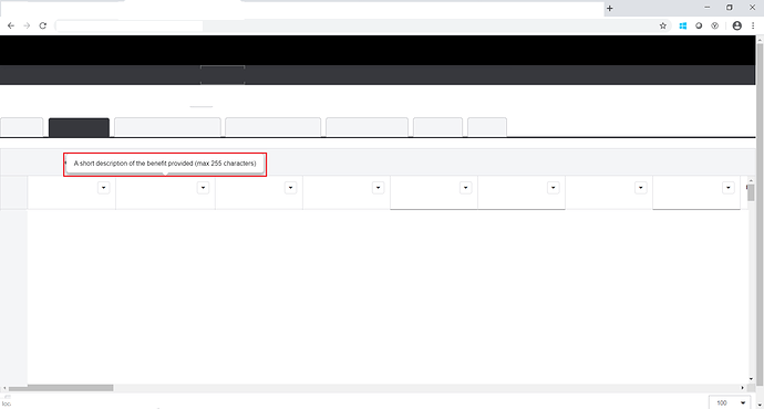

  • Posted 24 December 2019, 9:06 am EST - Updated 3 October 2022, 6:24 pm EST
    Hi Ashwin & Manish,
    After Implementation, I am facing the Issue like whenever move came out of column area also earlier/previous tooltip still visible at that previous position.
    It’s suppose to be hide/dispose. But, it’s not doing most cases like fast moving etc.
    Attached the Screen shot for the same.
    Thanks & Regards,
    Chiranjeevi D
