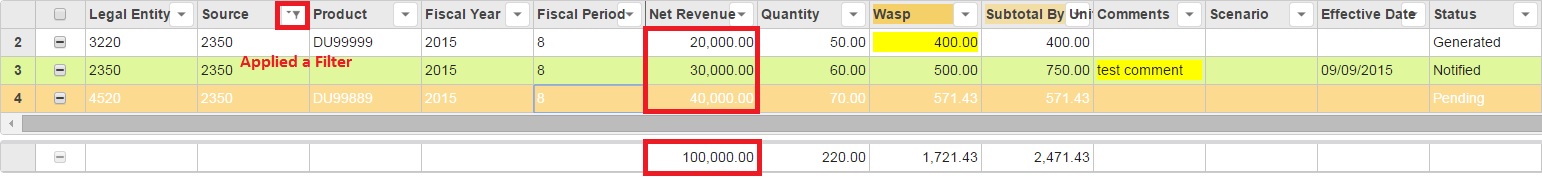

    Thanks for the sample. I was able to integrate your code to my application and got it working. However, I noticed a problem with row filtering.
    I was able to display the grand total of each column in the footer grid, which is absolutely working fine. But, when I apply row filtering, the summary values are not getting changed based on the values currently displayed in the grid. Do you know how to refresh summaries upon row filtering?
    Attached the snapshot for your easy reference. Thank you in advance!
  • Posted 14 September 2017, 11:11 am EST
    You can handle the collectionChanged event of the master FlexGrid collectionView, so as to update the footer values when the user applies filtering in the master FlexGrid.
    Kindly refer to the attached sample which implements the same. Hope it helps.
