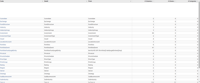

    We’re having an issue with Wijmo for Angular, whereby if a grid that has been hidden from view comes back into view, the rendering on it is messed up until either: the grid is refreshed OR the user scrolls out of view and back into view. See screenshot for what this looks like (the big white space).
    Is this a known issue? Is there any workaround? We’ve been trying to force grid refreshes, but we need a way to solve this problem on all of our pages without monkeying around with each individually.
