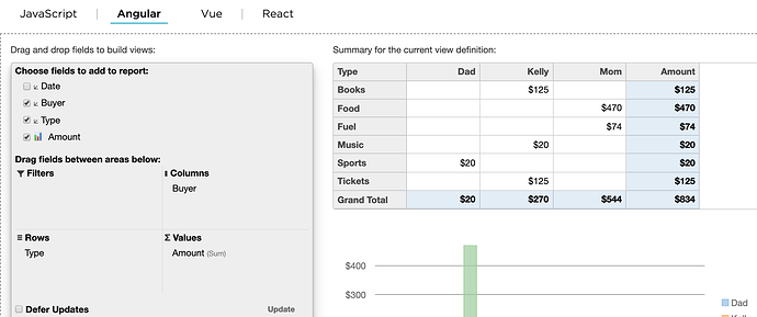

    From the snapshot below, how to just hide the column “Amount” from pivotGrid and Panel. But still preserve the buyer amounts.

    You can set the showColumnTotals value to wijmo.olap.ShowTotals.None. This will hide all the column totals. Similarly, you can hide the row totals also by using the showRowTotals property of PivotEngine.
    https://www.grapecity.com/wijmo/api/classes/wijmo_olap.pivotengine.html#showcolumntotals

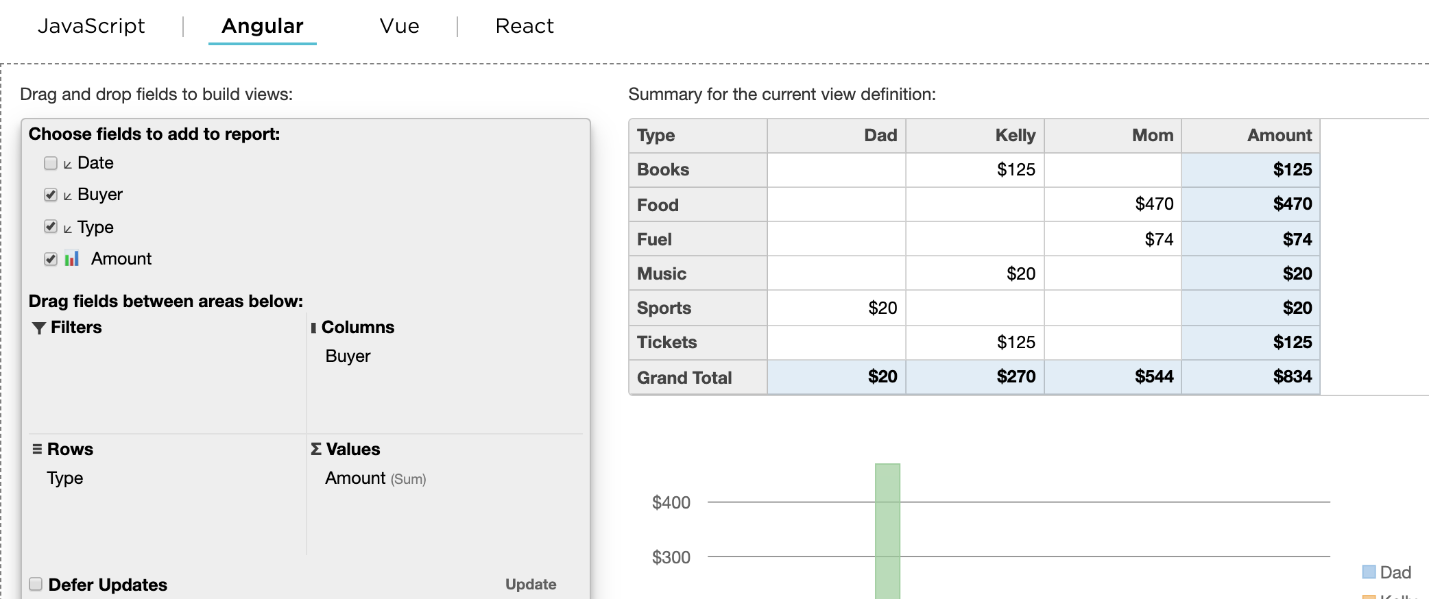

    Another question: If I decide to keep the “Amount” column and when the I filter out some values (Eg: Say remove Kelly) then I see the amount is changing with respect to the filter.
    I would like to have the Amount column remain static. How can I achieve this ?

    The behavior you observed is by design. As the filter is applied on any field, the aggregate data is calculated accordingly and display in PivotGrid.
    However, to retain the Amount Column value as it is, you may hide the specific column by getting its index. Please refer to the following code snippet for reference:
     var pivotGrid = wijmo.Control.getControl(selector);
     pivotGrid.columns[2].visible=false;
