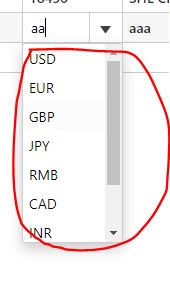

    In the attachment, I have used the Wijmo AutoComplete control which shows the list of results (marked).
    In there, I want to add a Wijmo grid in order to show some more information to the user so that the user can select a row to set the value for the AutoComplete.

  • Posted 17 December 2020, 12:21 pm EST - Updated 3 October 2022, 2:59 pm EST
    I apologize, I did attach the screenshot before also. Not sure why it got away.

    Hi Chhavi,
    Please refer to the following demo which demonstrates how we could format the dropdown items as a table/grid to show more information:
    https://www.grapecity.com/wijmo/demos/Input/ComboBox/Multi-column/purejs
