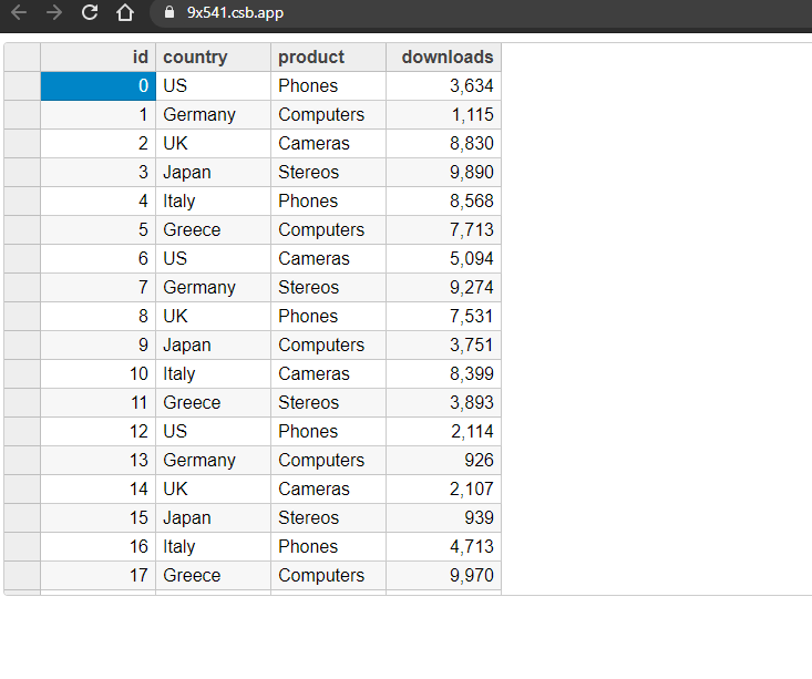

  • Posted 25 November 2020, 4:03 am EST - Updated 3 October 2022, 3:08 pm EST
    We are sorry but we are unable to replicate the issue at our end. Please have a look at the following sample and let us know if we are missing something in order to replicate the issue: https://codesandbox.io/s/wijmo-angular-forked-9x541?file=/src/app/app.component.html
    I’ve also attached a gif of our observation for your reference.
    Sharad
