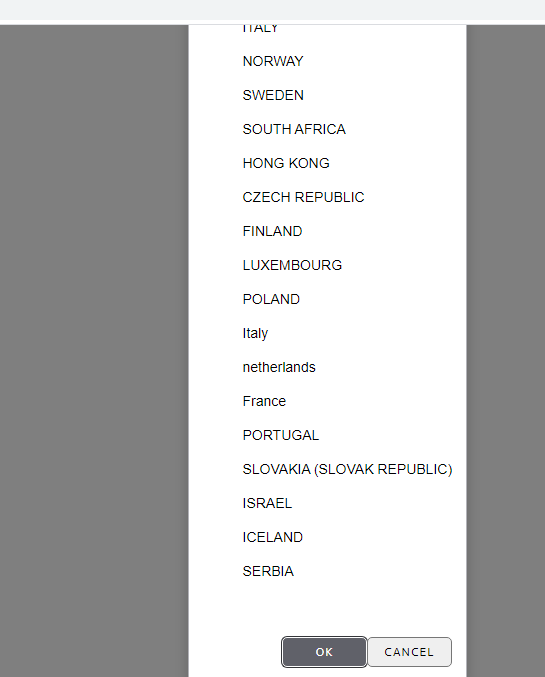

    when i click search button popup will open with list of countries populated on grid.when i select one value and click ok button value populated all rows columns.
    i want update only one cell
