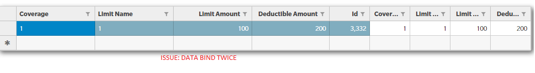

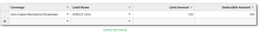

    We have Angular 7 wizard application in which user can able to bind the data from excel sheet into wijmo flex grid. I can able to successfully import the data, bind it inside the model and then save it into the database when user clicks on NEXT button. The problem is when user comes back to previous page it binds data twice with the selected value property and not the display property. Can you please let me know how to bind the data again into grid ?

    I have found the root cause. Basically when I import the data in Flexgrid then it loses all the binding made to the FlexGrid columns. So the grid now have the different column layout. Is there any way we can apply the ‘binding’ property again. I have attached two column layouts of a grid. One before imports the data and one after it. Please check and let me know how we can achieve this functionality ?

    From what I understand, you have already created columns in the FlexGrid before importing the excel file. And when the excel file is imported, the column layout of the FlexGrid changes and the binding property gets removed.
    If this is your issue, then you may avoid this by saving the columnLayout property of the FlexGrid before importing the excel file and then assigning it again to the grid after importing the excel file.
