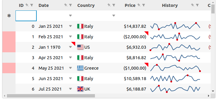

    My table has scroll horizontal and I use validate like this (https://www.grapecity.com/wijmo/demos/Grid/Overview/react). My problem that I want to display text show total cells invalid in table.
    Example: Has 5 invalids cell in table
    So, somebody help me count total cells invalid in table wijmo. Thank you.
