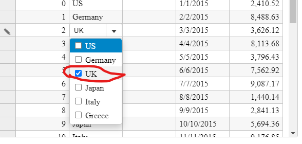

    I’ve added a dropdown in Wijmo with selectable options. I’d like to disable the ability to select a specific value from the dropdown. Please find a sample grid dropdown over the grid in the attached screenshot.

    You can handle the formatItem event of MultiSelect and add the wj-state-disabled CSS on items you would like to disable as per your requirement. Please refer to the sample link below for reference:
    https://stackblitz.com/edit/js-dkpqch?file=index.js
