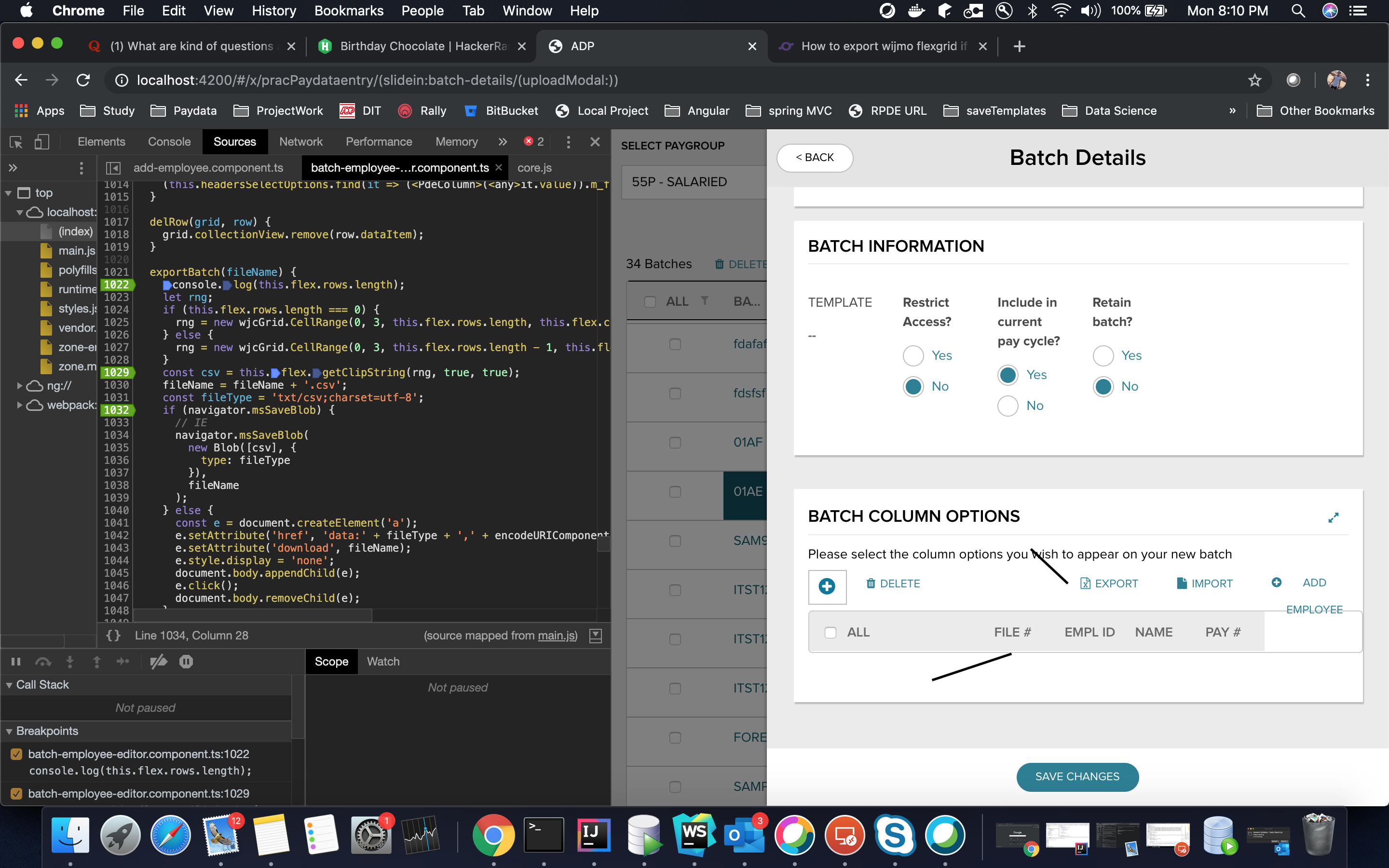

    We want to export flexgrid header into CSV file even if flexgrid contains no rows but it should contain rowheaders.
    Please find the code.
    exportBatch(fileName) {
    console.log(this.flex.rows.length);
    let rng;
    if (this.flex.rows.length === 0) {
    rng = new wjcGrid.CellRange(0, 3, this.flex.rows.length, this.flex.columns.length - 1);
    } else {
    rng = new wjcGrid.CellRange(0, 3, this.flex.rows.length - 1, this.flex.columns.length - 1);
    const csv = this.flex.getClipString(rng, true, true);
    fileName = fileName + ‘.csv’;
    const fileType = ‘txt/csv;charset=utf-8’;
    if (navigator.msSaveBlob) {
    // IE
    navigator.msSaveBlob(
    new Blob([csv], {
    type: fileType
    fileName
    } else {
    const e = document.createElement(‘a’);
    e.setAttribute(‘href’, ‘data:’ + fileType + ‘,’ + encodeURIComponent(csv));
    e.setAttribute(‘download’, fileName);
    e.style.display = ‘none’;
    document.body.appendChild(e);
    e.click();
    document.body.removeChild(e);
