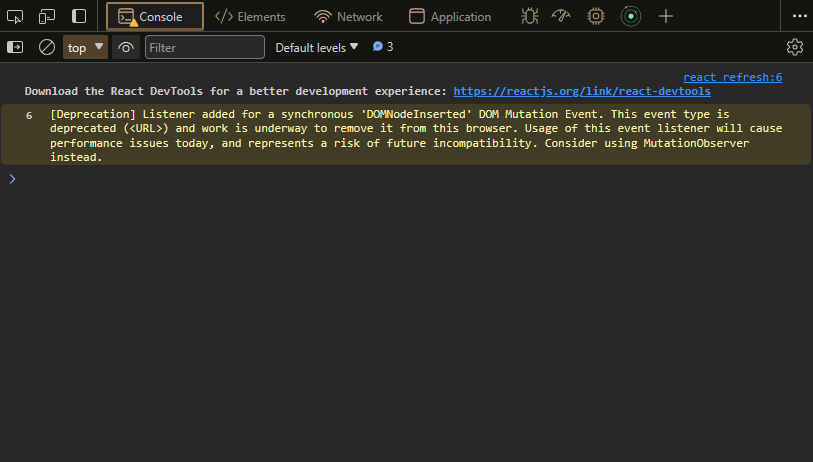

    Using the FlexGrid column component results in a DOMNodeInserted warning
    Document Type
    restriction
    Occurrence environment
    Occurs in Angular modules, Vue modules, React modules, and Web Components modules
    situation
    There is a workaround
    detail
    [Deprecation] Listener added for a synchronous ‘DOMNodeInserted’ DOM Mutation Event. This event type is deprecated () and work is underway to remove it from this browser. Usage of this event listener will cause performance issues today, and represents a risk of future incompatibility. Consider using MutationObserver instead.
    I was try render column in FUNCTION initialize setting grid but column is dynamic and grid does not rerender.
    I using “@grapecity/wijmo.all”: “^5.20202.732”.
    what can i do to fix it? help me please!!
    [/quote][/code]
  • Posted 19 December 2023, 1:22 am EST
    This issue has been already fixed in the latest release 5.20232.939. You may verify the same from this link: https://stackblitz.com/edit/react-xfptz8
    However, if you are not able to update the version in your application, then to dynamically insert the columns in the FlexGrid, please use the push() method on the Columns collection associated with the FlexGrid.

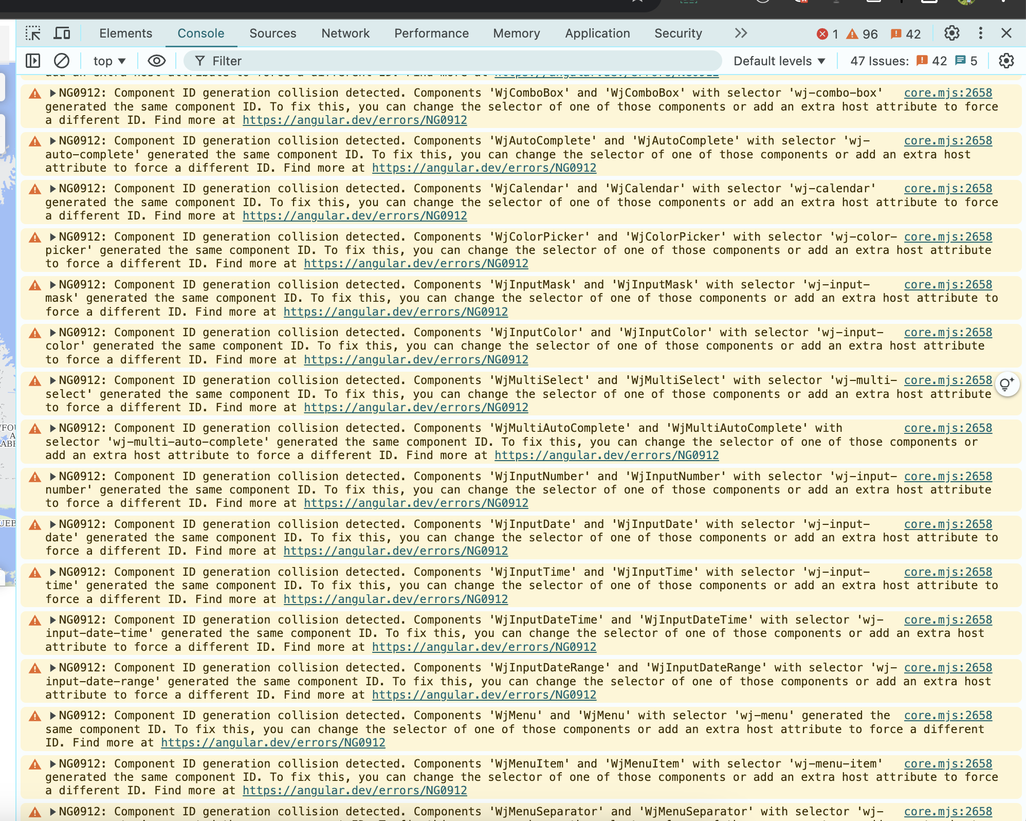

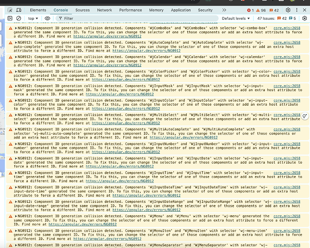

  • Posted 3 December 2024, 9:05 am EST - Updated 3 December 2024, 9:10 am EST
    Hi Team, In my case, when I updated to version 5.20232.939, “DOMNodeInserted” errors have been removed, but now we are getting other multiple warnings. and I am using the JavaScript version on Wijmo.
    what can i do to fix it? help me, please!!
  • Posted 4 December 2024, 5:58 am EST
    Hi Surya,
    It seems you also created a new thread for this issue, we have addressed the issue there, here’s a copy of the response -
    Sorry, but we are unable to replicate the issue on our end, could you please share a small sample in which the issue can be replicated, so that we can investigate the issue further and assist you accordingly?
    Please refer to the attached sample in which we tried to replicate the issue. You can also modify the attached sample to replicate the issue and share it with us.
    This type of warning may appear when a package is getting imported multiple times, so please make sure this is not causing the issue in your project.
    In case, if there is something we missed, please let us know.
    New Case link - https://developer.mescius.com/forums/wijmo/how-to-fix-component-id-generation-collision-detected
