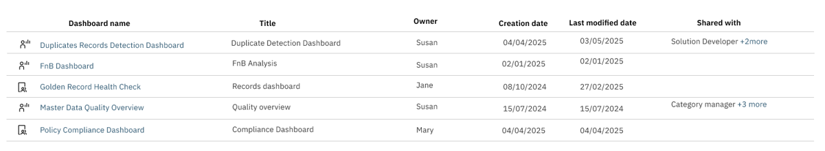

    I’m currently using wj-flex-grid in my Angular app to render a dashboard list, and I’m trying to replicate the behavior shown in the attached screenshot.
    I bind data to the grid using gridData = dashboardData;
    dashboardData contains dashboard info such as dashboardName, dashboardTitle, creatorName, creationDate, and roleIds (for access roles)
    Grid is rendered using wj-flex-grid with column templates
    1. Dashboard Name column should be a clickable row
    Clicking on any value in the Dashboard Name column (e.g., “FnB Dashboard”, “Golden Record Health Check”) should navigate to a new screen (Angular route), like:
    /dashboard/:dashboardId
    In the screenshot, the dashboard names show an icon and underline on hover — the visual hint that they are clickable.
    Query ->How can I make a FlexGrid column act as a router link (or clickable element) that redirects to a dynamic route like /dashboard/{{item.dashboardId}}?
    2. Shared With column should show “+X more”
    In the Shared With column, I want to display:
    The first role name (e.g., “Solution Developer”)
    A clickable text like +2 more when there are additional roles
    Clicking “+X more” should open a popup or dialog showing the full role list (Vendor, Admin, etc.)
    Query → What’s the best way to achieve this using Wijmo-compatible Angular logic?
    How can I show a popup (or tooltip/modal) from inside the grid when “+X more” is clicked?

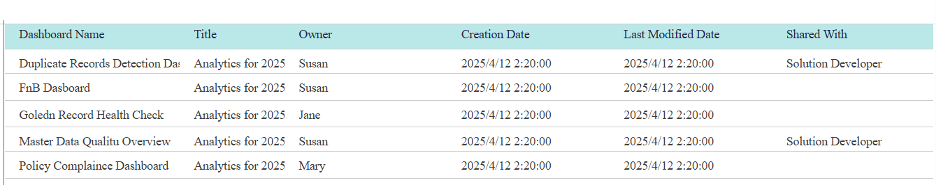

            <!--  Start of Dashboard Name column  -->
            <wj-flex-grid-column [binding]="'dashboardName'"
                                 [header]="'Dashboard Name'"
                                 [isReadOnly]=true
                                 [width]="200">
                <ng-template wjFlexGridCellTemplate
                             [cellType]="'ColumnHeader'"
                             let-cell="cell"
                             #headerTooltip>
                    <div class="header-tooltip"
                         [wjTooltip]="cell.col.header">
                        {{cell.col.header}}
                    </div>
                </ng-template>
                             cellType="Cell"
                             let-item="item">
                    <div [wjTooltip]="item.dashboardName"
                         class="item-name-wrap">
                        <span class="text-ellipsis-single-line item-name">{{ item.dashboardName }}</span>
                    </div>
                </ng-template>
            </wj-flex-grid-column>
            <!--  Start of Title Name column  -->
            <wj-flex-grid-column [binding]="'dashboardTitle'"
                                 [header]="'Title'"
                                 [width]="120">
            <!--  Start of Owner Name column  -->
            <wj-flex-grid-column [binding]="'creatorName'"
                                 [header]="'Owner'"
                                 [width]="'*'">
            <!--  Start of Creation Date Name column  -->
            <wj-flex-grid-column [binding]="'creationDate'"
                                 [header]="'Creation Date'"
                                 [width]="'*'">
            <!--  Start of Last modified date Name column  -->
            <wj-flex-grid-column [binding]="'lastModifiedDate'"
                                 [header]="'Last Modified Date'"
                                 [width]="'*'">
                             cellType="Cell"
                             let-item="item">
                    <div [wjTooltip]="item.lastModifiedDate"
                        <span class="text-ellipsis-single-line item-name">{{ item.lastModifiedDate }}</span>
                    </div>
                </ng-template>
            <!--  Start of Shared With Name column  -->
            <wj-flex-grid-column [binding]="'roleIds'"
                                 [header]="'Shared With'"
                                 [width]="'*'">
                             let-cell="cell"
                             #headerTooltip>
                        {{cell.col.header}}
                    </div>
                </ng-template>
                             cellType="Cell"
                             let-item="item">
                    <div [wjTooltip]=" item.roleIds?.at(0)?.name"
                        <span class="text-ellipsis-single-line item-name">{{ item.roleIds?.at(0)?.name }}</span>
                        <span *ngIf="item.roleIds.length>1"
                    </div>
                </ng-template>
        </wj-flex-grid>
    </div>
    [/code]
    1. What is the recommended way in Wijmo FlexGrid Angular to make a cell (e.g., dashboardName) act like a router link to navigate on click?
    2. For conditional rendering in a cell (e.g., showing “+X more”), how can we cleanly implement a popup/modal that appears on click within FlexGrid’s template?
    A working StackBlitz example will be helpful.
    Expected screenshot
    Current screenshot as per above code
  • Posted 26 June 2025, 3:02 am EST
    Hi Nilesh,
    The code you shared for navigating to other routes for the ‘Dashboard Name’ column is already working as expected. Please refer to the sample below demonstrating the same. Please note that we have demonstrated navigation to the Hello component or Home component pages only for the dashboard links in the sample.
    Regarding your second requirement, you can use the Popup control to show the roles data in the popup when available. Please refer to the sample below for the same.
    Sample link - https://stackblitz.com/edit/angular-ivy-vfz3myv9?file=src%2Fapp%2Fgrid%2Fgrid.component.html
    Popup API - https://developer.mescius.com/wijmo/api/classes/Wijmo_Input.Popup.html
    Popup Demo - https://developer.mescius.com/wijmo/demos/Input/Popup/Dialogs/angular
