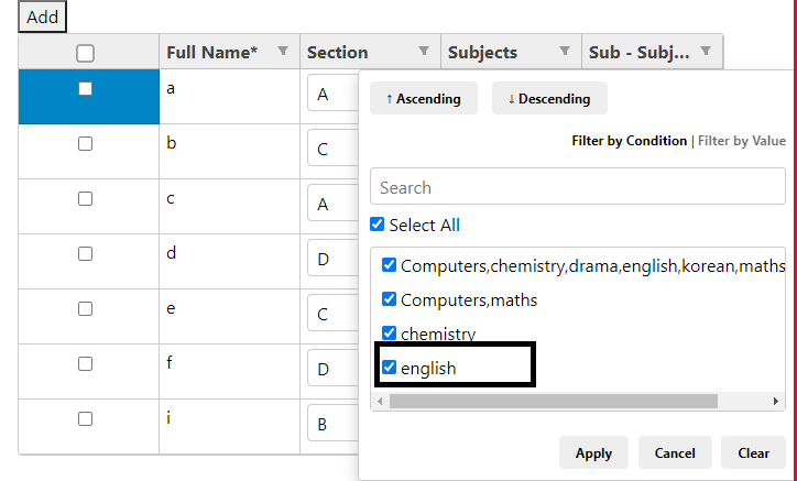

    Hi Team,
    We have a requirement where we are changing a displayed value in subjects column (English to ‘7’). So in case we will have to remove the english value from filter by value .
    Applied code - ( lines - 194-196)
    https://stackblitz.com/edit/angular-rownit?file=src/app/app.component.ts
    We want to remove this from filter since it is not displayed on the UI.
    Please provide Solution.

    To implement the above requirement, we may perform the following:
    • "* “We may make use of the editingFilter event of FlexGrid filter which occurs when a column filter is about to be edited by the user.”
    • “To get the filter for a given column, we may make use of getColumnFilter() of FlexGird filter which gets the filter for a given column.”
    • “We may use the getUniqueValues() method of valueFilter to get an array containing objects representing all unique values for this column.”
    • “We may perform the required manipulation and assign the final array to the uniqueValues property of ValeuFilter.”
    Please refer to the code snippet:
      filterEditing(grid, filter, e) {
        if (grid.columns[e.col].binding == 'subjects') {
          let valueFilter = filter.getColumnFilter('subjects', true).valueFilter;
          let customUniqueValues = [];
          valueFilter.getUniqueValues().forEach(item => {
            if (item.value.indexOf('english') >= 0) {
              if (item.value.length > 1) {
                let str = item.text;
                str = str.replace('english', '');
                customUniqueValues.push(str);
            } else {
              customUniqueValues.push(item.text);
          valueFilter.uniqueValues = customUniqueValues;
    Sample: https://stackblitz.com/edit/angular-tykcmw
