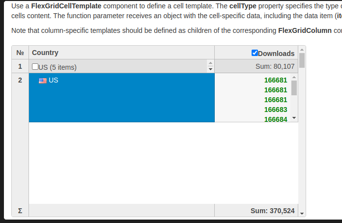

    I want to scroll a cell inside a table that is also scrolling. I have searched a lot but still have no answer. Please help me. I bought your license. Below is the file I sent. I used the current library and I added some customizations to have scroll in a cell.
  • Posted 22 November 2023, 4:17 am EST - Updated 22 November 2023, 4:27 am EST
    Describe image
  • Posted 23 November 2023, 9:02 am EST
    You can add a class to the desired cells. Then you may style such cells as below:
    .custom-scrollable {
      overflow-y: auto;
      height: 80px; /* set height as per the requirement*/
    Also, to make the content scrollable please handle the “wheel” event on the hostElement of the FlexGrid and use the stopImmediatePropagation() for the required cells so that the default “wheel” listener can be prevented from being called when the target element of scrolling is the cell with custom class.
    Please refer to this sample for reference: https://stackblitz.com/edit/react-r1bhht
