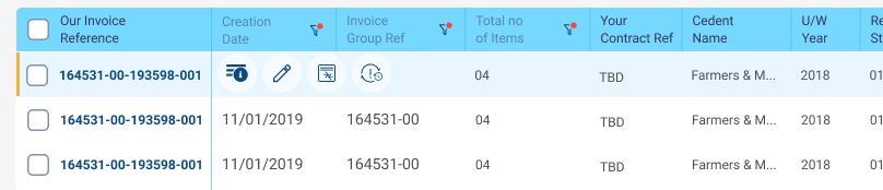

    I need to show 3 icons horizontally on the hover of the cells in the first column inside flexgrid using angular. and I need to fire click event for each icon.
    I have tried like creating wijmo popup on hover and added these icons inside popup. but i couldn’t able to set the background of the icons as transparent.
    Here I am attaching the image for my requirment .

    To set the background of icons inside popUp we may attach a css class to these span elements which represents the icons and may set the background property to transparent.
    If we wish to make any changes in the popUp background color, we may set the same css to the wj-popup css selector.
    Please refer to the sample below:
    https://stackblitz.com/edit/angular-oqmz9b
