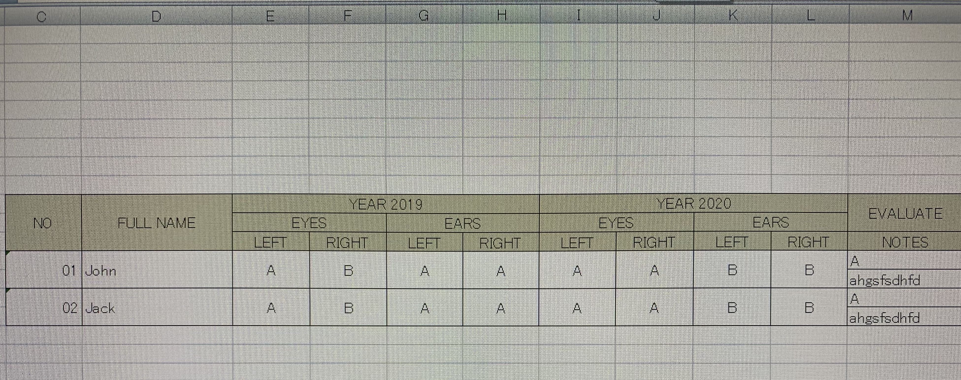

    Hi everyone,
    I want to create a multi-row grid, so I use WjMultiRow through properties:

    But, My grid just have 2 lines/recor when I want to my header have 3 lines (Please see attached photo)
    I have tried many ways but still have not found the answer, please help me if you have any idea
    Thanks!

    The MultiRow is a little bit different control then FlexGrid. You cannot add a single row to the columnHeaders of the MultiRow. The number of rows added should be equal to the number of records per item, which is 2 in your case.
    So, you will need to add 2 rows to the headers and hide anyone of them.
    To merge the data in this new row, you will need to add your own custom merging logic by overriding the getMergedRange method of the MultiRow.
    You may refer to the sample attached for reference.
