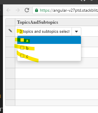

    how to use wj-multi-select with List of string(not a list of the object) in wj-flex-grid-column in Angular 2+?
    I was trying but it is not working properly. checked items are not showing as checked like below here is how I was trying to
    do - https://stackblitz.com/edit/angular-v27ptd?file=app%2Fapp.component.html
    Mitesh
  • Posted 24 February 2021, 6:27 am EST - Updated 3 October 2022, 2:15 pm EST
    here is the image of that issue
  • Posted 25 February 2021, 4:52 am EST
    Hi Mitesh,
    There seems to be an issue with MultiSelect and FlexGrid. Is it necessary to use the angular component of MultiSelect? If it is not, then I can update the CustomGridEditor class to accommodate MultiSelect also.
