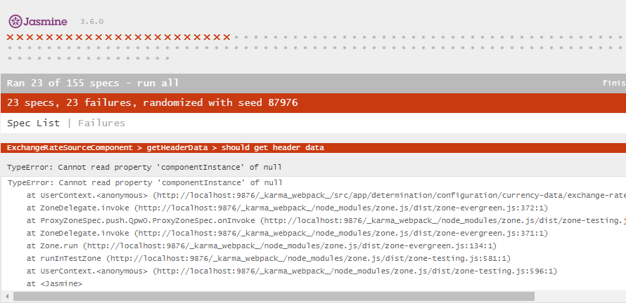

    Hi, good day. I am trying to initialize the WjFlexGridDetail in my angular unit test. I tried doing this:
    beforeEach(() => {
            fixture = TestBed.createComponent(ExchangeRateSourceComponent);
            component = fixture.componentInstance;
            //grid init
            appComDebugElement = fixture.debugElement;
            gridDetailDebug = appComDebugElement.query(By.directive(WjFlexGridDetail));
            gridDetail = gridDetailDebug.componentInstance;
            fixture.detectChanges();
    but i got this error
    TypeError: Cannot read property 'componentInstance' of null
    may i know if this is the right approach to initialized the WjFlexGridDetail for unit test?

  • Posted 23 August 2021, 8:25 am EST - Updated 3 October 2022, 12:43 pm EST
    hi Sharad,
    yes, the error still occurring please see below my code

    but the error occurrs on the part for the debug element
  • Posted 24 August 2021, 3:01 am EST
    Thank you for the code snippet.
    The issue is arising because you are trying to get the gridDetailProvider instance using the debugElement.query() method. It is used to query DOM elements and since gridDetailProvider is applied on the template, a valid instance is not found.
    To get the detail provider instance, we could use @viewChild on the component and then use the debugElement.componentInstance.gridDetailInsanceName to get the detail provider instance. I’ve prepared a sample to demonstrate the same. Please refer to the attached sample.
