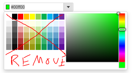

    I would like to remove the palette from the left side of the wj-input-color control. Is that possible?

    Hi Eric,
    You will need to update the controlTemplate of the ColorPicker control to hide the palette from the drop-down. You will also need to reduce the width of the drop-down accordingly. Please refer to the sample link below for reference:
    https://stackblitz.com/edit/ckkyne-xjofa5
