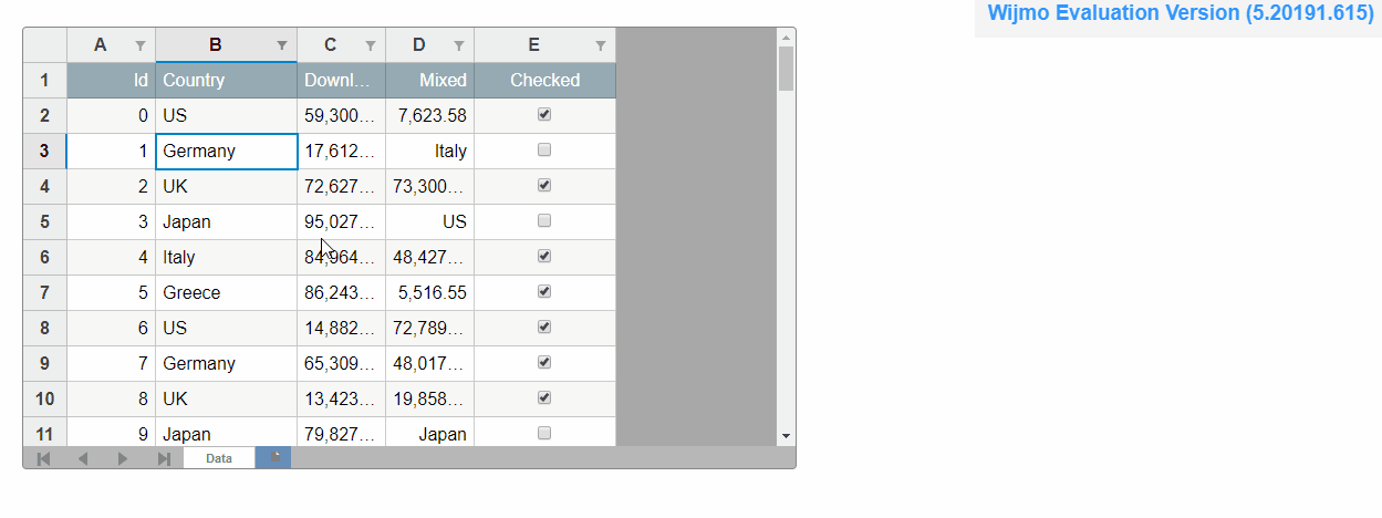

    You can verify that the autofill is working by creating a new application with FlexSheet and testing autofill in this. If it works fine, that means there is an issue with your existing project. You can also verify that the autofill works in the provided version by using the sample and screenshot below:
    https://stackblitz.com/edit/angular-vu6nnr

    Hi Ashwin,
    Thanks for sharing the sample with the same version. :slight_smile: I can’t say this for sure but since we are using custom styling and formatting in flex sheet cells so this may be blocking this feature or there could be other things in my project. I am gonna change that for a while and will see if that works.
