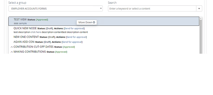

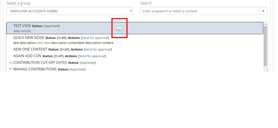

    I have used Wijmo 5.20171.282 version with Angular 5.2.0 version.
    This same source code working in Angular 2 version but Angular 5 it’s breaking. Is any one faced like this?
    Please refer screen shot
    In Angular 5:
    in Angular 2:
    In HTML:

  • Posted 4 September 2019, 7:06 am EST
    The reason that the code is not working is that the provided version of wijmo was released in March’17 and angular 5 was release in Nov’17. Therefore the provided wijmo version is not compatible with angular 5. The compatibility with angular 5 was added in the 17v2 version of wijmo. So, I would suggest you upgrade your wijmo version.
    Let us know if you face any issues while upgrading.
