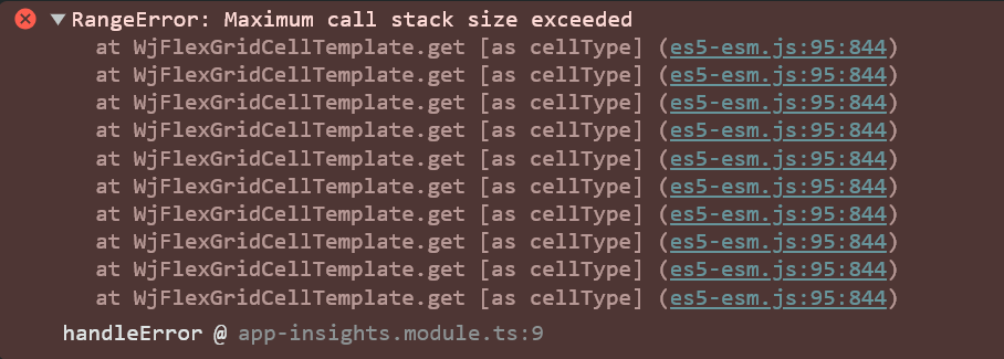

    We are in the process of upgrading our project to Angular 19 and we are on Wijmo Library 5.20251.34.
    After upgrading Wijmo and Angular, our grids partially render however the wjFlexGridCellTemplate does not and throws the Maximum call stack size exceeded error. We were earlier on Angular 18 and Wijmo 5.20231.904
    The cell types we use are Cell, CellEdit, ColumnHeader, ColumnFooter, GroupHeader.
    Can you please help us figure out the issue? Our application is unusable at the moment.
