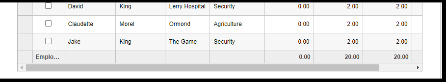

    I am currently working on a FlexGrid with a columnFooter, However, upon checking the wijmo code, grids allowMerging property doesn’t have a columnFooter option (like cellType = 5), I’ve already tried using allowMerging = ‘All’ and set allowMerging = true on columnFooter rows but columnFooters are not merged horizontally.
    Please Advice. Thanks!

    The column footers are not merged automatically. You will need to extend the MergeManager class to provide your own merging logic. Please refer to the sample link below for reference:
    https://stackblitz.com/edit/js-hdee2r
