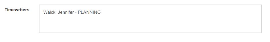

    Hi Team,
    I am using MultiAutoComplete to select multiple items from the drop down list. After selecting the first value multi auto complete doesnt allow to select the second value.
    Here is my auto complete code.
    <wj-multi-auto-complete #txtTimeWriters
    [itemsSourceFunction]=“sourceFunction”
    [displayMemberPath]=“‘displayName’”
    [selectedValuePath]=“‘userPrincipalName’”
    [placeholder]=“‘Timewriters’”
    [isEditable]=“true”
    ngModel>
    sourceFunction = (query: string, max: number, callback: Function) => {
        const query_length = query.length;
        // empty query? no results OR if query length is > 14 (only true if Wijmo AutoComplete is in edit mode)
        if (!query || query_length > 14) {
            callback(null);
            return;
        let strApi;
        strApi = this.m_strEmployeeApiPath + query + '\')';
        return this.m_dbService.getGraphData(strApi)
        .subscribe
            data => {
                // find items that start with the user input
                const allItems = data.value,
                queryItems = [],
                rx = new RegExp('^' + query, 'i');
                for (let i = 0; i < allItems.length && queryItems.length < max; i++) {
                    if (rx.test(allItems[i].displayName)) {
                        queryItems.push({
                            displayName: allItems[i].displayName + ' - ' + allItems[i].department,
                            userPrincipalName: allItems[i].userPrincipalName,
                            officeLocation: allItems[i].officeLocation
                callback(queryItems);
            errorCode => {
                console.log('Http get request to MS Graph failed. ErrorCode:  ' + errorCode);
    Appreciate your response.
