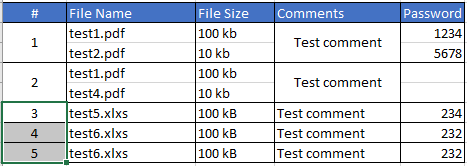

    Hi, I am currently using Wijmo Multirow grid.
    I just have a question if it is possible to create something like this using multirow?
    The “#” column is supposed to be a checkbox. And every time I will add a new row, it will be one row like 3,4 and 5.

    Could you please provide some more information on the requirements for the first 2 rows in the shared image? if you want to achieve merging for the first two rows in the “#” and “Comments” columns then I would recommend you to use the FlexGrid control which is better suitable for simple layouts. Please refer to the given link below for reference:
    https://www.grapecity.com/wijmo/demos/Grid/Merging/RestrictedMerging/purejs
    Let us know if you have further queries.

    As you can see I am using multirow and the 0th and 1st index are for the 1 and 2 row in the image above, and the 2nd index is the one for the 3rd row. I wanted to hide the cell with fileName, fileSize and filePassword if they are blank or empty string. Is that possible with multirow? or do you have any suggestion?

    The example you provided hides the row itself, as for my case I wanted to hide the cells for fileName, fileSize and filePassword and will still show the cell for pdfFileName, pdfFileSize and pdfPassword.
  • Posted 2 February 2022, 8:19 am EST
    I’m afraid that hiding a cell would not be possible as only hiding a specific cell would affect the multiRow layout and also would not make sense. As per my understanding, you only want to hide the cell with fileName, fileSize, and filePassword if they are the blank or empty string, if so then the above-provided solution would work for you. In the sample link above both last rows are set to visible false because of the provided data(after removing the 4th row, 5th rows data cell of fileName, fileSize, and filePassword become empty which results in 5th to hide as well).
