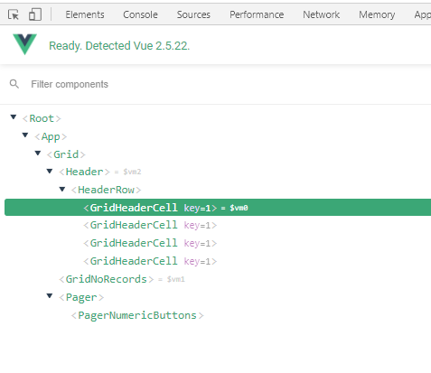

    I am checking FlexGrid and Kendo UI Grid where Kendo explicitly mentioned that it has both wrapper and native Vue components. But, slot template is only available in native Vue component.
    https://www.telerik.com/kendo-vue-ui/components/grid/#toc-native-vs-wrapper-grid-component
    But, I have noticed similar slot template blog for flex grid.
    https://www.grapecity.com/blogs/vue-cell-templates-for-the-flexgrid
    So, my primary query is whether FlexGrid is native component or wrapper component?

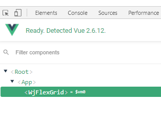

    We can refer the difference in vue developer tools.

    https://www.grapecity.com/wijmo/docs/GettingStarted/Vue-Components
    I found the answer from the below documentation. Vue FlexGrid is wrapper.
  • Posted 16 December 2020, 12:40 am EST
    Please anyone can answer for this query.
  • Posted 16 December 2020, 8:53 pm EST
    Hi Nagarajan,
    Thank you for evaluating wijmo. As mentioned in the document you shared, wijmo Flexgrid is a PureJS component and the provided vue component is a wrapper around our purejs flexgrid for allowing easy integration in the framework and take full advantage of the features provided by the framework.
