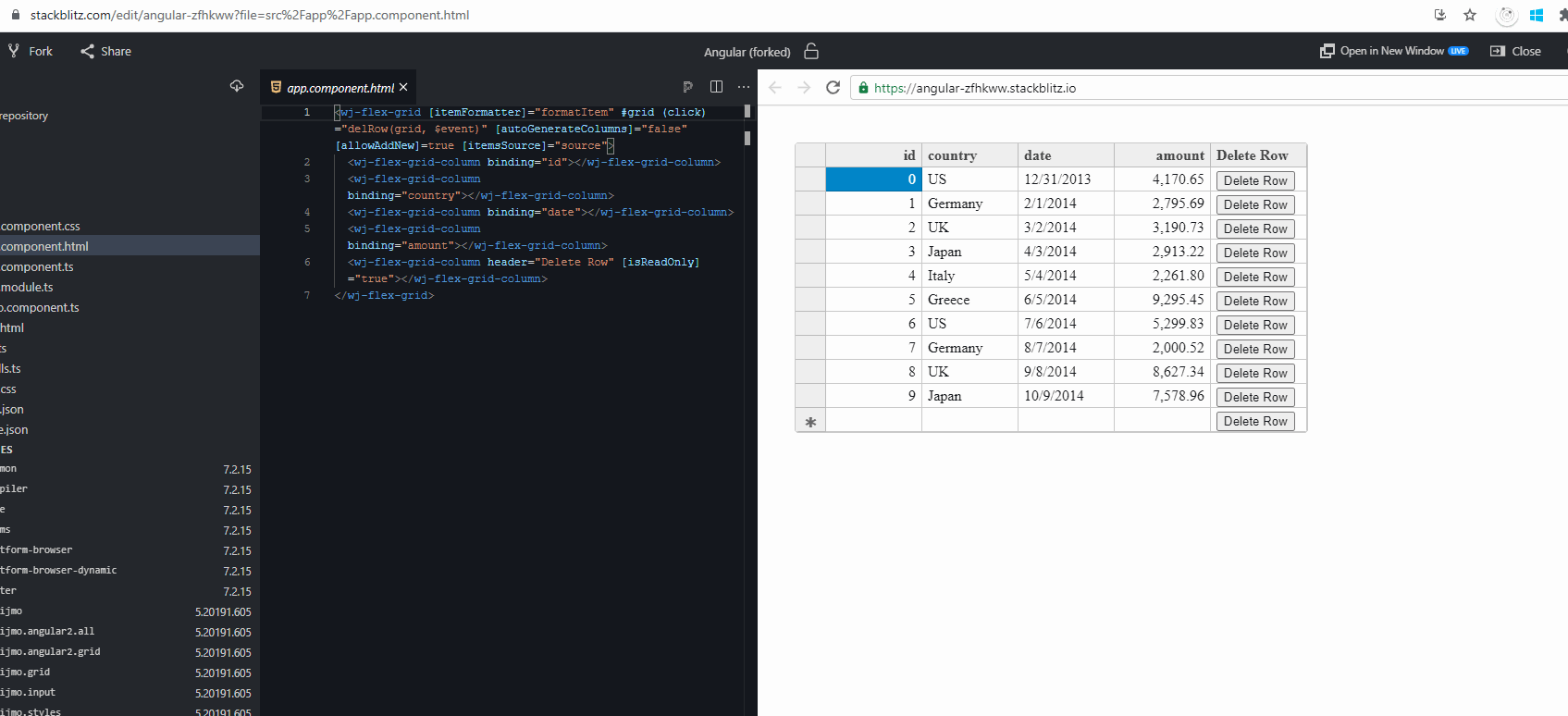

    When a user adds two rows to the grid and when focus is on the last row, if user tries to click on the delete button in second last row, click event doesn’t trigger. On second click on same button, the event is triggered.
    I was able to reproduce that in one of the StackBlitz link with a wijo felx grid example.
    Please find the link below
    https://stackblitz.com/edit/angular-zfhkww?file=src%2Fapp%2Fapp.component.html
    Also adding a gif file to show the behaviour.

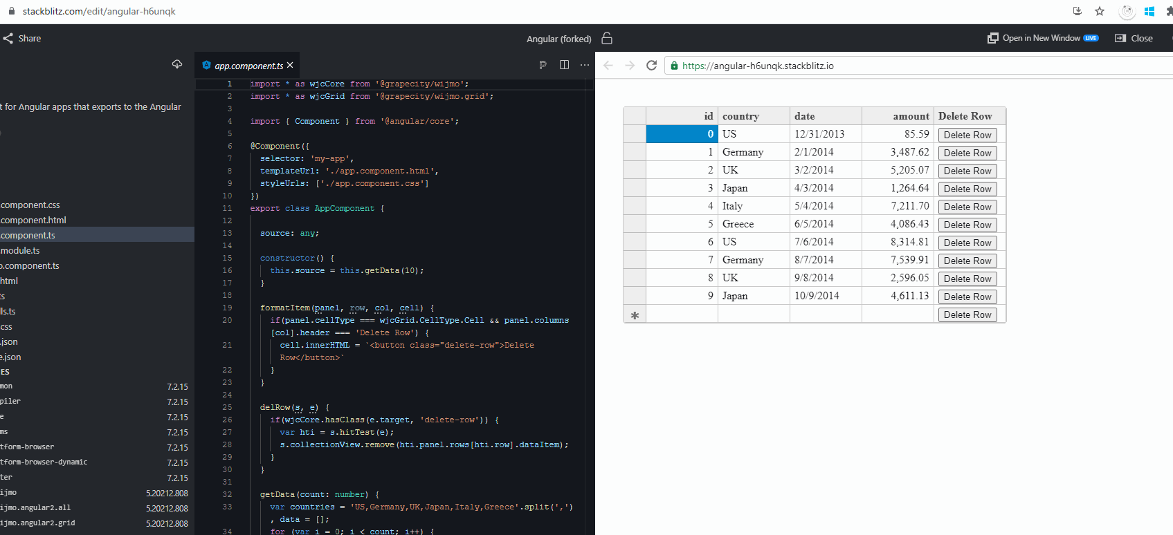

    The issue has already been fixed in the latest wijmo build 5.20212.808. You may update the wijmo build to resolve the issue. Please refer to the updated stackblitz sample below:
    https://stackblitz.com/edit/angular-h6unqk
    Let us know if you have any doubts or issues.
  • Posted 5 August 2021, 8:51 am EST - Updated 3 October 2022, 1:02 pm EST
    Hi Ahwin,
    Thanks for the reply.
    I checked in the link: https://stackblitz.com/edit/angular-h6unqk
    I am still seeing the issue.
    Please let me know if I am doing something wrong here.
    Arun Sunny
