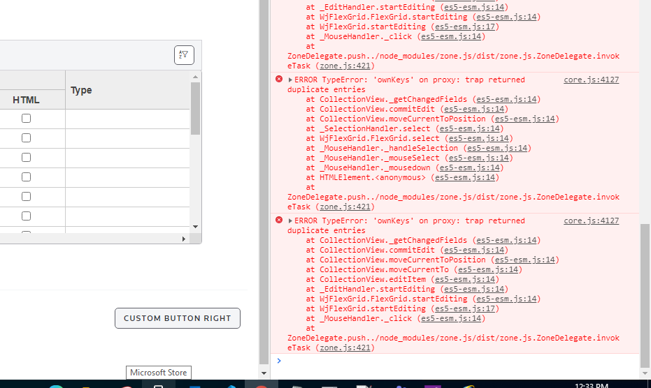

  • Posted 8 February 2021, 11:13 pm EST
    when i click checkbox i am getting this error
    ERROR TypeError: ‘ownKeys’ on proxy: trap returned duplicate entries

    when i click check box this two handler fired.i am getting that error,sometimes hitting ,sometime getting error
  • Posted 9 February 2021, 1:01 am EST
    I’m unable to replicate the issue using the previously shared sample. Please share the exact steps to replicate the issue, also confirm if you are able to observe the issue in the shared sample too? If not, please share a sample that replicates the issue.
  • Posted 9 February 2021, 2:56 am EST
    if possible to implement in angular 2 code using
    1)when i click checkbox cellEditEnding not fired getting error

    i got the issue where it is,it is in
    this.data = new wjcCore.CollectionView(this.reportsDataReports, {
    calculatedFields: {
    Favorite: $ => +$.favorite
    how can i bind in angular calculatedFields,if i am removing calculatedfiels issue resolved but favorite icon not shown in grid

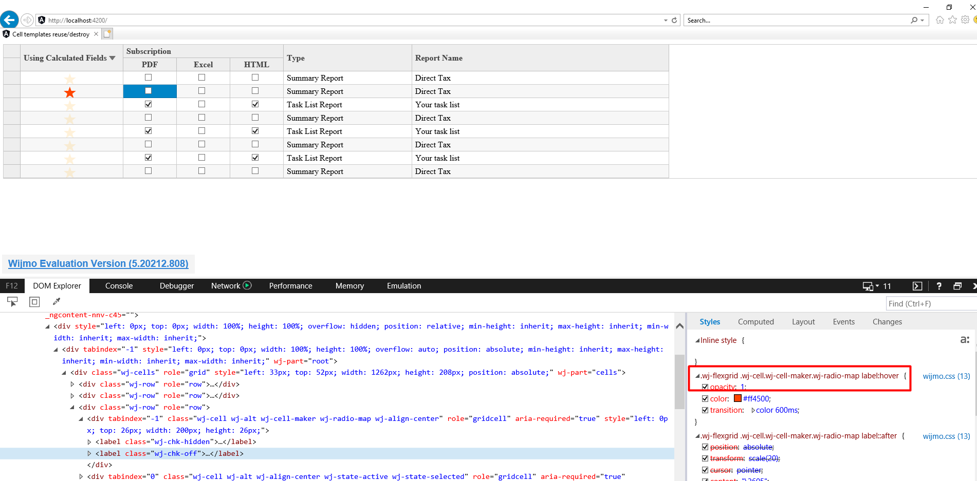

    when i click fav icon type as detail report(row) its moved top(sorted) that working fine but where i am clicked that place still it is active favicon that type as difference(index as changed) we cannot see active icon here. we need to see here inactive mode.
    expected :we need to see here inactive mode.

  • Posted 9 August 2021, 10:55 am EST
    example: if i am clicked 10 row fav icon cell this item moved top, but favicon still 10th place active status(after moved top next report is here). please refer above screen shot.it will not occurs every time, only some cases it is appear.

  • Posted 10 August 2021, 10:13 am EST
    i am not facing issue in chrome, this issue occurs in IE,
    https://codesandbox.io/s/wijmo-angular-forked-ohkzm?file=/src/app/app.component.ts
    this url not running on ie
  • Posted 10 August 2021, 10:25 am EST
    5 to 10 times select favicon icon see icon is active same place or not
  • Posted 10 August 2021, 10:26 am EST
    i am facing this issue on ie only
  • Posted 11 August 2021, 2:25 am EST - Updated 3 October 2022, 12:53 pm EST
    I’m able to replicate the issue in IE11 as well. The observed issue is not related to the wijmo but it is IE bug. Sometimes, even if we are not hovering over the start icon, IE add the hovers style to it. Please refer to the gif below, in the gif notice that :hover style is applied on the star even though we are not hovering over it.
