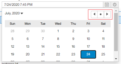

    We are using ‘wj-input-date-time’. We need to give tooltip title on action buttons (next, previous, and today’s day) on the calendar.
    Can you guide us on the same?
    Attaching screenshot for better understanding:

    You can use the controlTemplate property of the Calendar class to add a title attribute to each action button. A title attribute is used to display a simple tooltip on the element. This is the easiest way but this will add the title property for all of the InputDateTime, InputDate, and Calendar control. If you do not have any issues with that, then you can use this method.
    The different solution is to use Wijmo’s Tooltip. You will need to get the reference of all the 3 action buttons and use the setTooltip method to add a tooltip on each of them.
    Please refer to the sample link below:
    https://stackblitz.com/edit/angular-9-0-0-rc-1-jgtfgb
