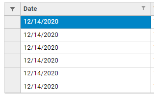

    The problem is that the Date column on my Flex Grid is not displaying time - it’s only showing the date:
    How can I make Flex Grid show the time and not just the date?
