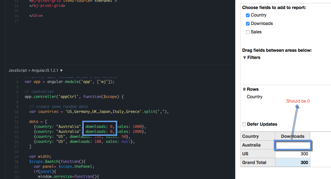

    Dear support,
    We noticed an issue in Wijmo OLAP:
    If all values of a particular key field is zero, then the aggregate SUM (or other types other than Count) in the grid becomes empty (null) which should actually be zero.
    Here’s a quick demo sample:
    http://jsfiddle.net/runninghare/acrtzw2y/14/
    Let me know whether it’s a bug or it’s on purpose. We need it to display as is. It should only be null when the actual values are real NULL.

    Hi James,
    The issue was recognized as a bug and is fixed in the latest nightly build. You may verify the same using the sample below:
    https://stackblitz.com/edit/js-hmackz
    PS: The nightly have not passed through the QA cycle and therefore they are not suitable in a production environment.
