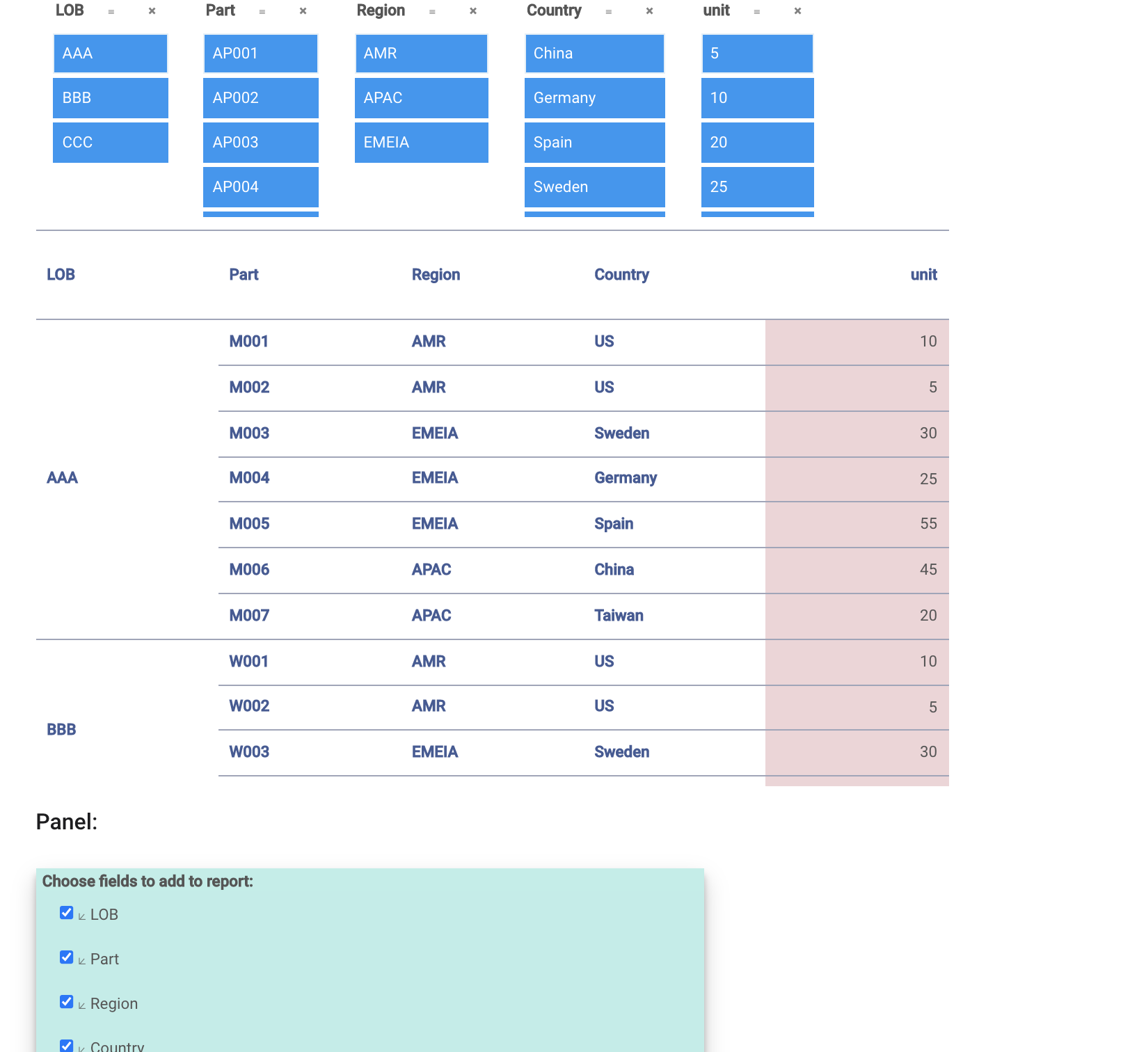

Olap pivotgrid - Onfilter change

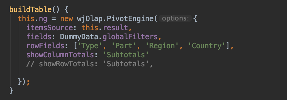

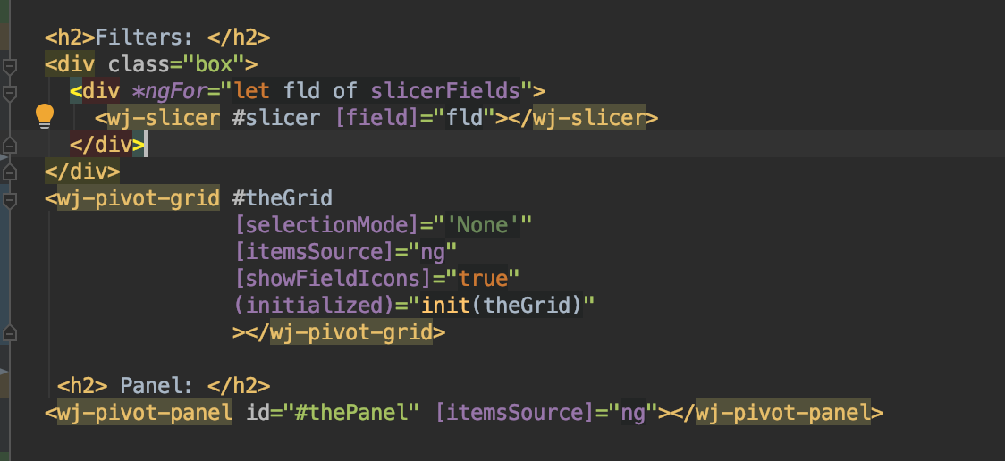

You may use the underlying instance of the listBox inside the Slicer and handle the selectedIndexChanged event of ListBox to get the information of the selectedItem or to update the pivotGrid data. Please refer to the API link for more information: https://www.grapecity.com/wijmo/api/classes/wijmo_input.listbox.html#selectedindexchanged
You may also refer to the sample demonstrating the same: https://stackblitz.com/edit/angular-wznebk?file=src%2Fapp%2Fapp.component.ts
