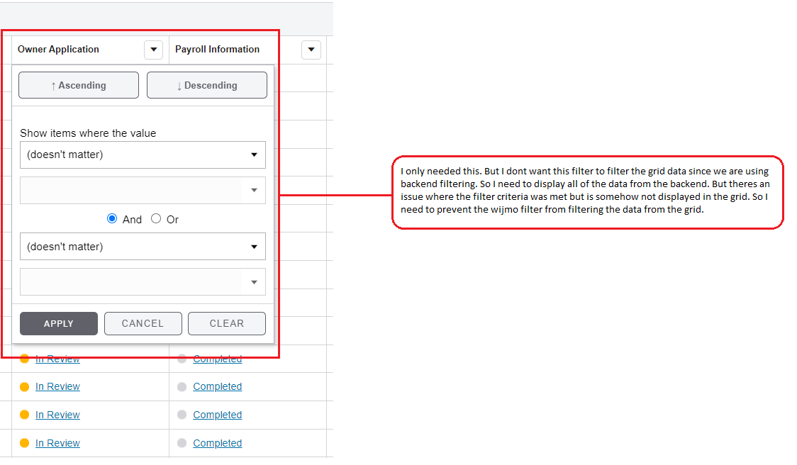

  • Posted 13 August 2020, 9:47 am EST - Updated 3 October 2022, 3:45 pm EST
    Hi Team,
    Please see the attached image. I needed the flexgrid filter to be on the flexgrid. What I’m trying to do is to prevent the wijmo filter on filtering the flexgrid data.
  • Posted 14 August 2020, 4:51 am EST
    Hello David,
    Thank you for explaining your requirement. As per the attached image, you would like to perform actions in the FlexGrid from the server. So for this, we have a ServerCollectionView class which can be used to apply the filtering, paging from the server.

  • Posted 17 August 2020, 9:01 am EST
    Thank you for the suggestion, but the backend filtering is already done. What I am trying to achieve is to prevent the wijmo filter from filtering the grid data. Is there a way to do that without using server collection view?

  • Posted 18 August 2020, 2:06 am EST
    Hello David,
    In this case, you need to override the default apply and clear method to execute filtering on a server.
    Please refer to the following code snippet for reference:
    // in case of pure js, replace wjGridFilter with wijmo.grid.filter
    wjGridFilter.FlexGridFilter.prototype.apply=function(){
            alert("Own Implementation");
    Hope it helps!
