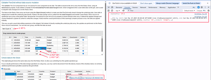

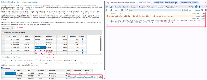

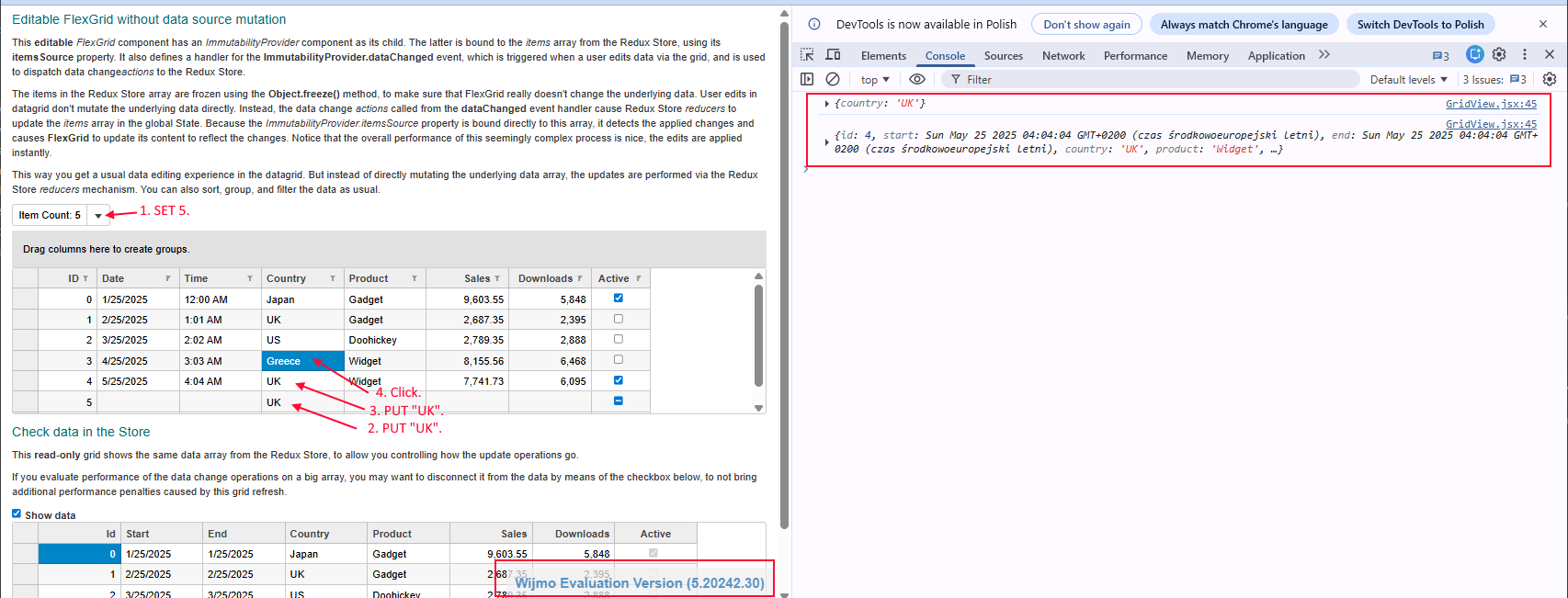

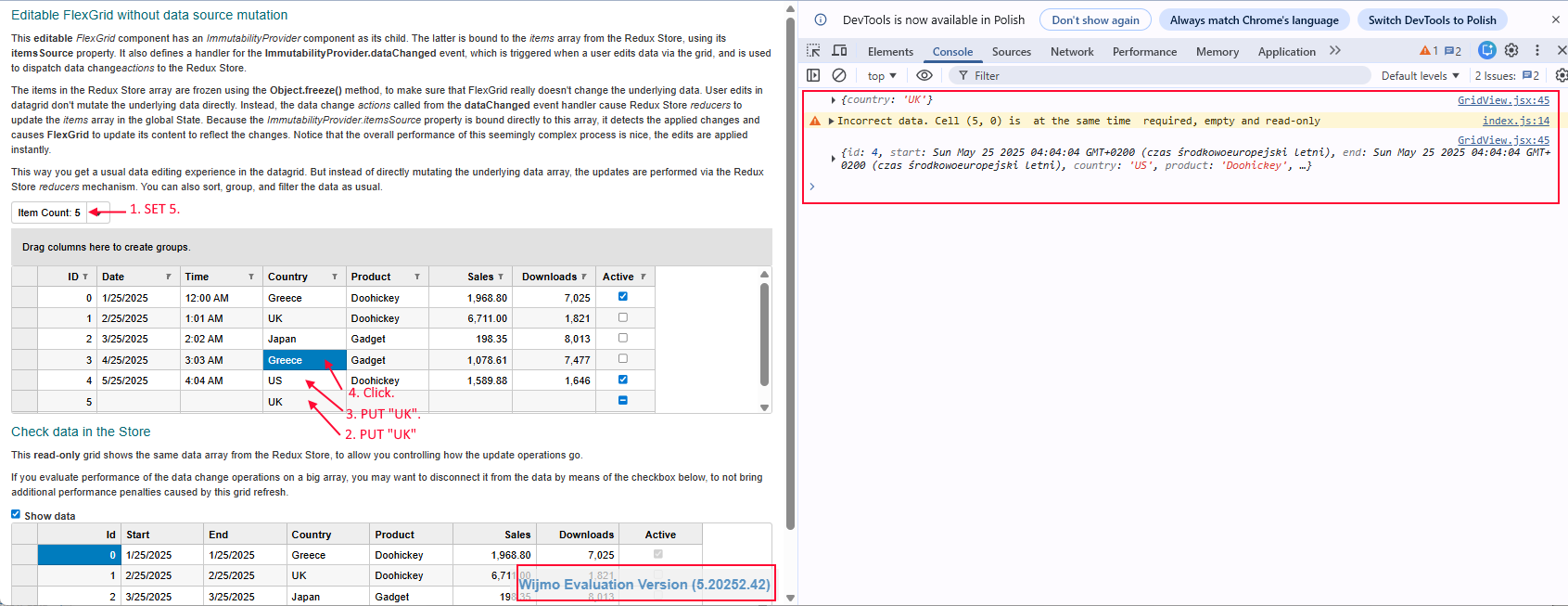

    I’ve investigated the issue, and it’s more complicated. I’ve attached an example and screenshots showing correct behavior on version 242.30 and incorrect behavior (changing the value doesn’t work under certain conditions) on version 252.42.

    We found that the ‘rowEditEnded’ event is not getting triggered when the row edit ends in the newly added row, which is causing this issue. We have forwarded this issue to the engineering team for further investigation with internal tracking ID - WJM-37158. We will update you when we have an update from the engineering team on the same.
    For now, as a workaround, you can manually trigger this event when needed. Please refer to the following code snippet -
