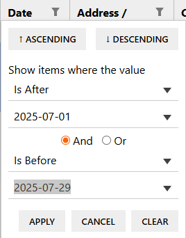

I would like to do something similar for a condition filter, namely be able to filter my “EngagementDate” column programmatically using javascript (similar to value filter above) or some other method. Essentially I would like to set the following filter conditions programatically on page start:
All of the ConditionFilter properties are readonly and can’t be set, unlike filterText for the valueFilter, you can see I was attempting to set the private c1 and c2 properties, but to no effect.
