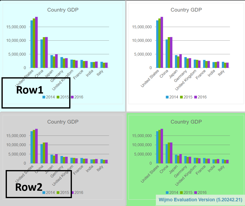

    I have two requirements I need help with:
    1. Drag-and-Drop Functionality:
      I would like to implement drag-and-drop for these charts. Specifically, users should be able to drag one chart and drop it into another section of the layout. Please provide solution where I can enable drag-and-drop behavior between chart containers?
    2. Controlled Expansion Behavior:
      In the current layout, the dashboard is divided into two rows (row 1 and row 2). When expanding a chart or section in row 1, the charts in row 2 are also shifting, which I don’t want.
      My goal is to restrict the expand/collapse behavior to only row 1, without affecting or moving row 2 charts. How can I achieve this separation so that row 2 remains fixed and unaffected by changes in row 1?
    I have attached below screenshot for your reference.
