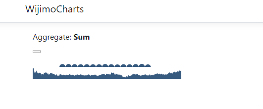

    I am struggling with the exmaple.
    https://www.grapecity.com/wijmo/demos/Chart/LineArea/AggregateDateSeries/angular
    After putting it into my project, it displays with issues.
    Then I create a clean page by inputting exact the code in the wijmo example page.
    Still got the displaying like below.
    The only thing I changed was the css import.
    import ‘bootstrap/dist/css/bootstrap.css’;
    import ‘wijmo/styles/wijmo.css’;
    import ‘./styles.css’;
    Others all same.
    May I know what shall I do to fix it?
    Thanks, mates.
    Cheers.

    Hi Kun,
    It seems that the CSS file is not loaded in your application. Please make sure that the CSS is loaded. Also, if you are using Angular, try creating a new project using angular-cli and add the CSS file in the styles config of the angular.json file.
    You may also refer to the sample attached for reference.
