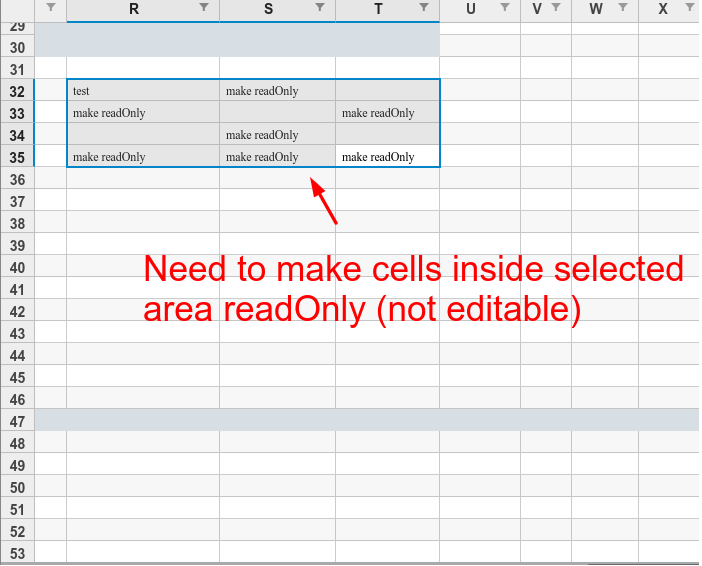

    Is there opportunity to make all selected “cells” read Only (selection can be from different columns and rows) ? And how can we configure “readOnly” option to remember it after calling save() or saveAsync() functions, as currently when we save excel file which contains readOnly columns then reopen it, it does not keep readOnly properties?
    I tried to apply workaround using “className” property for cells with “applyCellsStyle()” function, but in this case also after saving the file “className” is gone.

    Hi Soven,
    If you wish to have some read only cells, then you will need to maintain an array which contains all the cell’s row and column index, which is read-only. Then, you will need to handle the beginningEdit event, check whether the current cell can be edited or not using the read only array and cancel the event accordingly. Please refer to the sample link below for reference:
    https://stackblitz.com/edit/angular-zbevsb
    Unfortunately, this configuration cannot be exported to excel because cells in excel cannot be read-only. The excel has a protection method which can make the cells protected (or read-only) but it cannot be set while exporting the FlexSheet to excel.
    We are sorry for the inconvenience.
