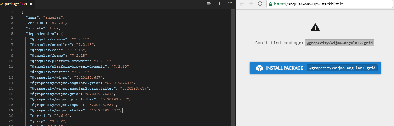

    regarding stackblitz:
    I forked my last sample (https://stackblitz.com/edit/angular-wawupw) and changed the wijmo dependencies to the actual version. stackblitz tried to install the dependencies but failed …

    Regarding Stackblitz:
    Could you please try using the ‘rc’ version of wijmo in the package.json file.

    regarding the Stackblitz problem:
    I found out that the following combination worked:
        "@grapecity/wijmo": "5.20193.637-rc",
        "@grapecity/wijmo.grid": "5.20193.637-rc",
        "@grapecity/wijmo.angular2.grid": "5.20193.637-rc",
        "@grapecity/wijmo.angular2.grid.filter": "5.20193.637-rc",
        "@grapecity/wijmo.grid.filter": "5.20193.637-rc",
        "@grapecity/wijmo.input": "5.20193.637",
        "@grapecity/wijmo.interop.grid": "^5.20193.637",
        "@grapecity/wijmo.styles": "5.20193.637",
    but please don’t ask me why :slight_smile:
