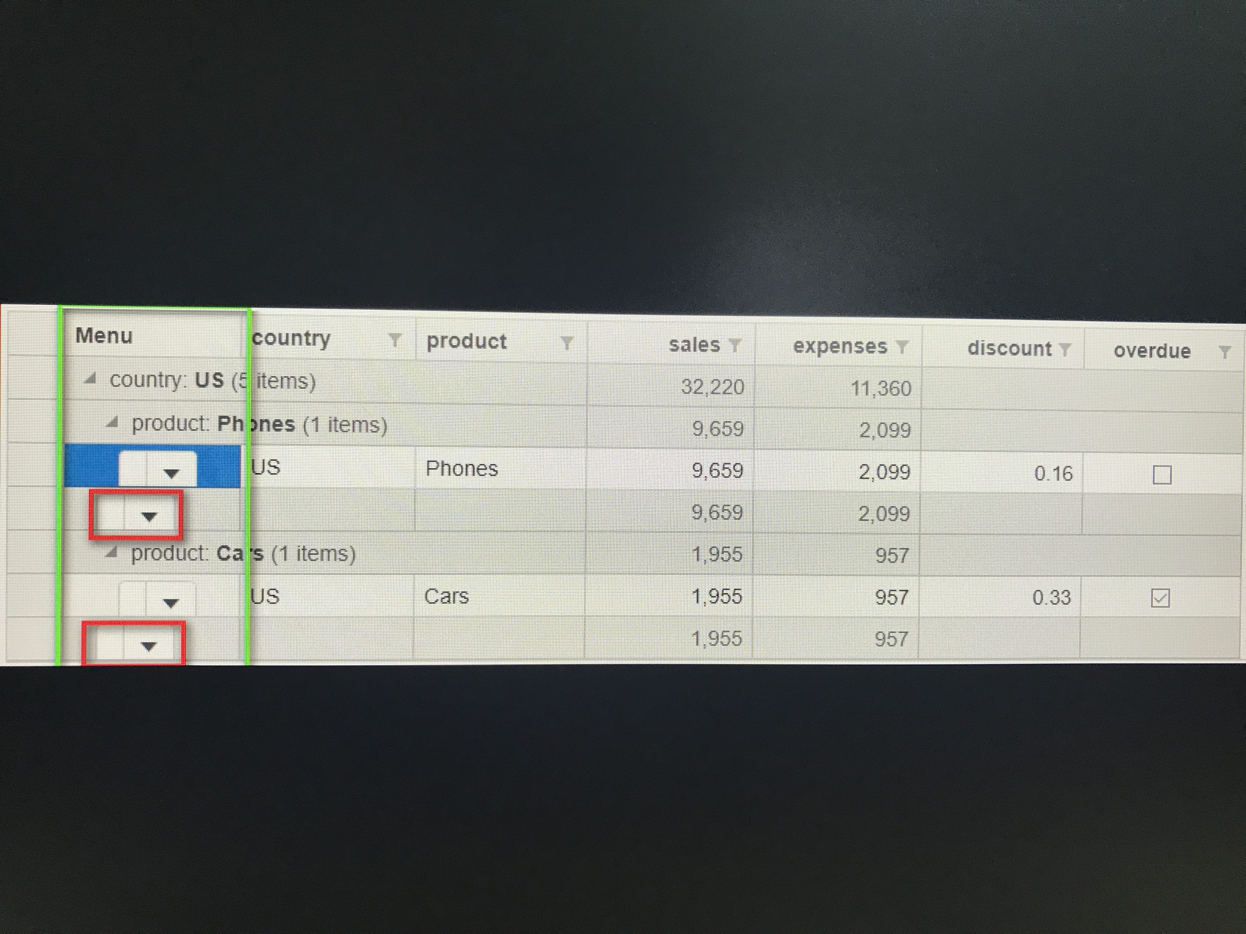

    I have a with first column is . But I want to replace some row with a text and I don’t know how to do it. Can you help me.
  • Posted 9 August 2020, 11:08 pm EST
  • Posted 9 August 2020, 11:15 pm EST - Updated 3 October 2022, 3:48 pm EST

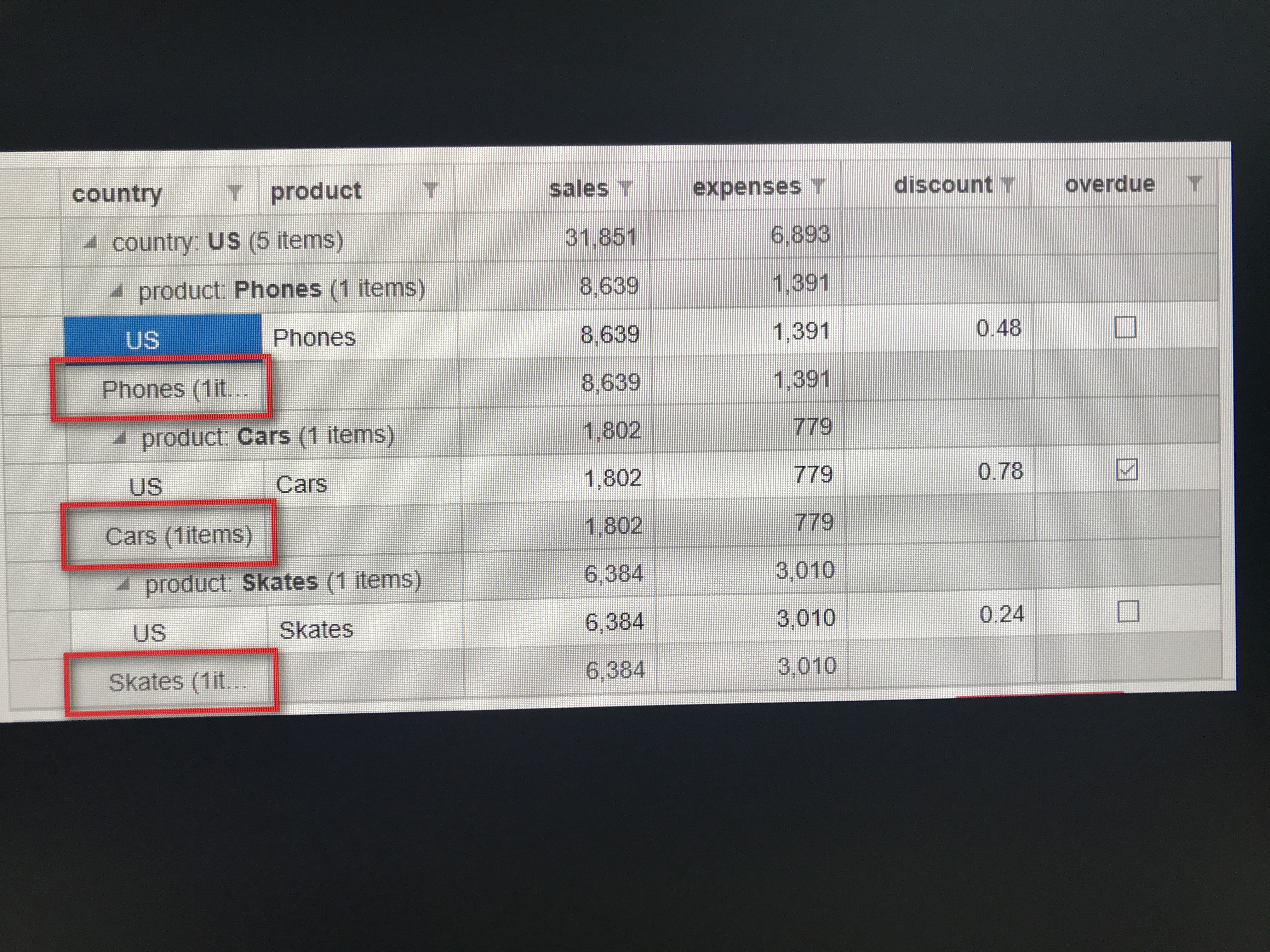

    And this is with . I want to replace the red square with the text in normal picture. Can you support me please
    Sorry, I took picture and upload by phone because my company network not allow upload picture

    Hi darkthanhtam,
    It seems that you need to add text only for group header rows and Menu for normal rows. If you have used cell templates, then you can easily use the cellType=Cell property to add menu to normal cells only. Please refer to the sample link below for reference:
    https://stackblitz.com/edit/angular-ucnjs2
    Let us know whether this was your requirement or not.
  • Posted 10 August 2020, 5:50 am EST
    Hi, Ashwin,
    That’s just normal situation, I want to odd line with ‘country name’ and even line with . Can you do that? And I was used Angular JS. Thanks.

  • Posted 11 August 2020, 12:54 am EST
    Hi Tam La,
    Please refer to the updated sample attached. In the sample, I have added a displayMenu method that takes a Row object as an argument and returns whether this row should have the menu or not. And using this method and the ng-if directive, we can change the display of menu.
    Currently, it only displays menu for even rows but not for group headers and group footers. But you can update this method accordingly. Also, the menu will not be displayed for group headers by default. For displaying in the group headers, you will need to use cell-type=“GroupHeader”.

  • Posted 11 August 2020, 3:29 am EST
    Thanks, that’s what I need, but the text of group footer row was showed at second column. I want to show at first column but it doesn’t work well. I hope you can help.
