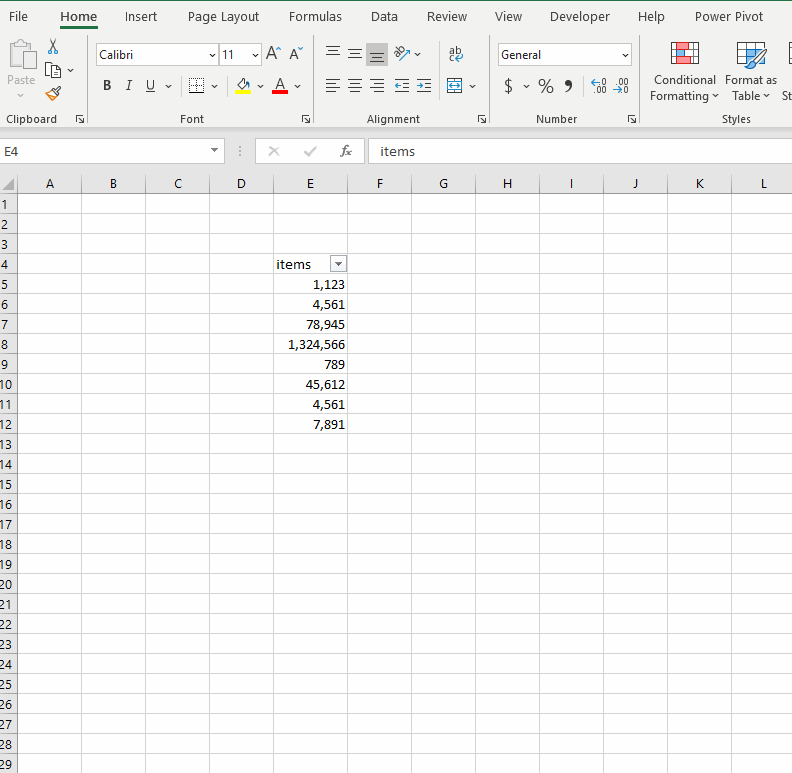

  • Posted 10 March 2021, 12:26 am EST - Updated 3 October 2022, 2:19 pm EST
    Regarding the value filter search behavior. The dev team has informed us that this behaviour is by design and matches the behaviour of excel filters. I’ve attached a gif of the same behaviour in MS Excel, please refer to the same:
