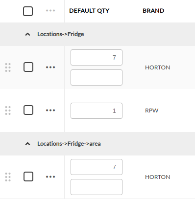

  • Posted 16 November 2023, 4:01 am EST
    okay, so when I update the value in any input I want to update multiple columns data.
    for example- I have two columns default qty and cart qty okay and a column that has a button add to cart then if I click on add to cart it should automatically update the cart qty input value as 1, if clicked again then 2 and accordingly.
    I am not able to update the grid data if any operation performed
