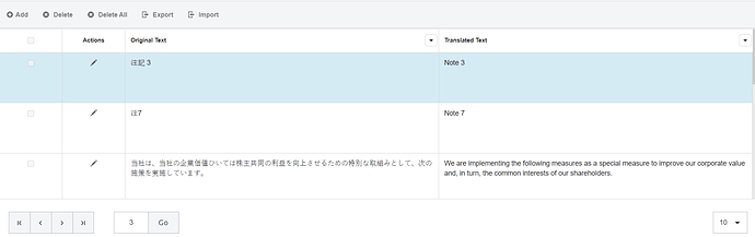

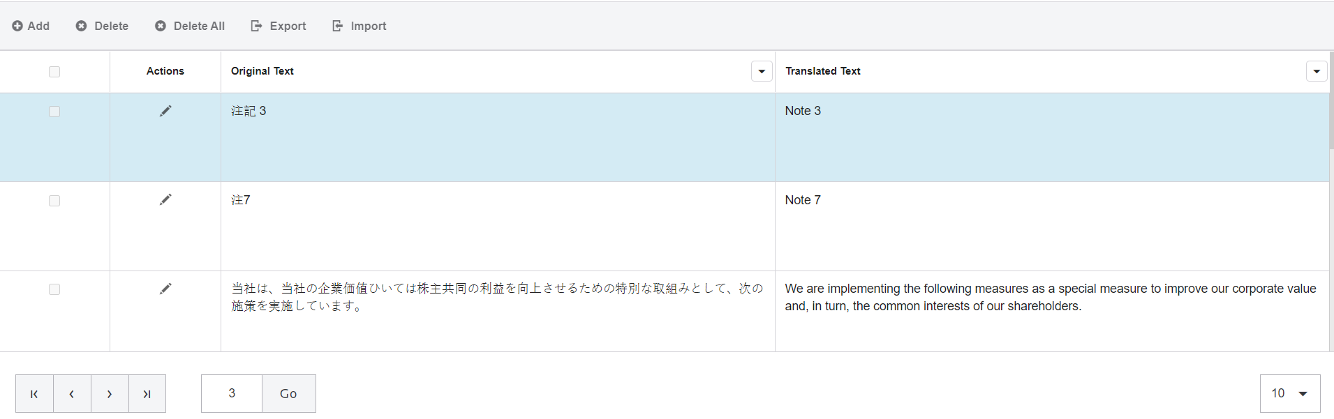

    Same Height is getting applied to all rows. can you please let us know how can i fix this.
    i used below code.
    $scope.init=function(s,e){
      	//enable word wrap
      	s.columns.getColumn('country').wordWrap=true;
        //auto size rows
      	s.autoSizeRows(0,s.rows.length);
  • Posted 1 September 2020, 3:04 pm EST - Updated 3 October 2022, 3:37 pm EST
    Image attached for visual refrence.
